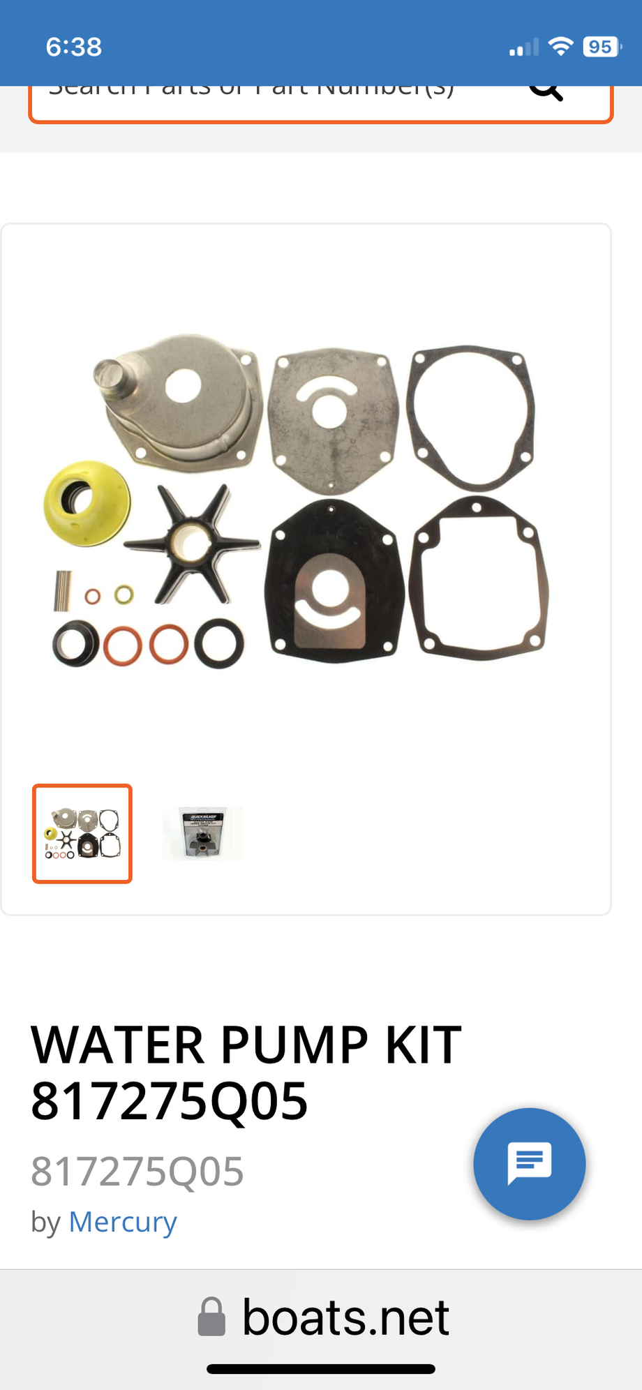

My stern drive is alpha1 gen 2 serial number 0F333583. I used quicksilver 8M0100526 water pump kit. Should I have used 817275Q05 Water Pump Impeller Repair Kit instead? It could explain some of my issues if so. Thank you

They are both for the gen II. It appears one has the oil seals and the other doesn’t.
What issues do you have and try to keep it in one thread please. I see you started 3 in one day over the same subject area. Thanks.

Here are pics of the two part #’s you listed
