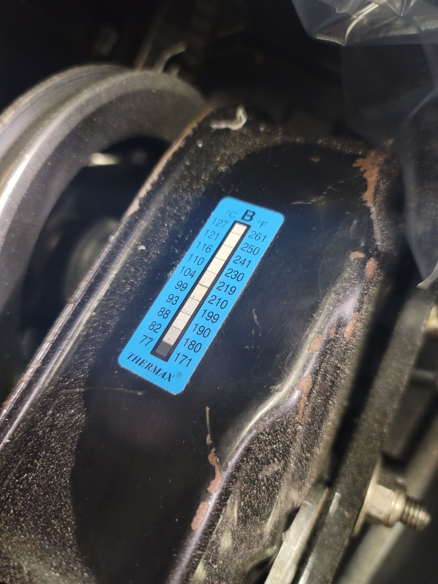

You can buy heat indicating strips from MC master Carr. put em on the drive and find out .

Old 08-02-2024 | 09:57 PM
jeff32's Avatar
Joined: Jun 2004
Posts: 8,230
Likes: 580
Nice but cant read it underway...

Old 08-03-2024 | 06:19 AM
SB
Joined: Nov 2004
Posts: 14,154
Likes: 3,714
From: On A Dirt Floor
True.
It will just stay at highest temperature it ‘records.’

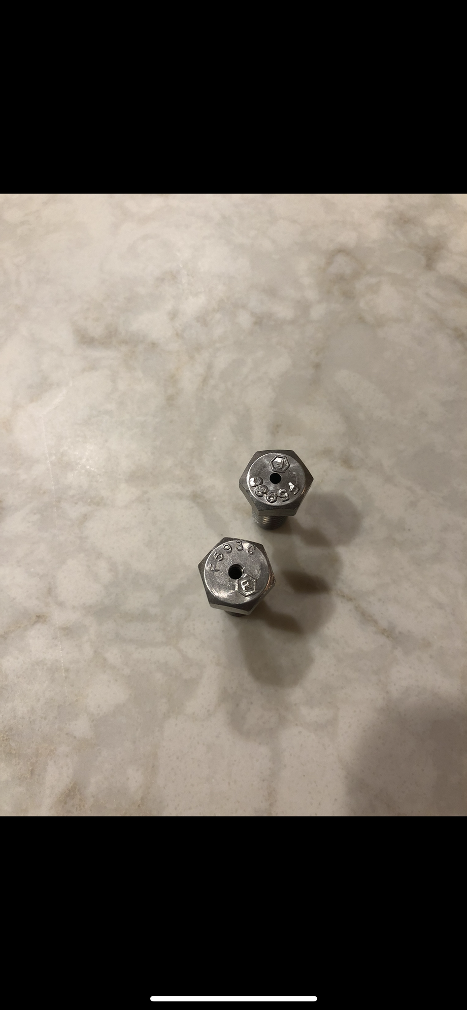

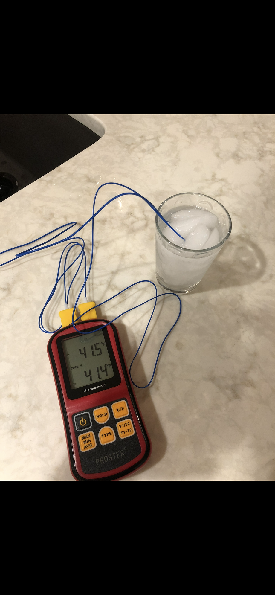

Old 08-03-2024 | 06:45 AM
Joined: Jun 2010
Posts: 4,838
Likes: 928
I tried this game 3 years ago and failed.
I took spare drive plugs and modified them by drilling holes. Then I took thermocouples and potted them and hooked up multi meters.
took it out for a test drive…. Never worked never got good readings. Why…because of grounding and a lot of electrical interference. Will post pics if I can find them.
1MOSES1 is offline
Old 08-03-2024 | 06:53 AM
Joined: Jun 2010
Posts: 4,838
Likes: 928
1MOSES1 is offline
Waiting for your solution ...
your solution is probably the cheapest and most reliable without spending $$$ on kits that claim to read oil accurately.
