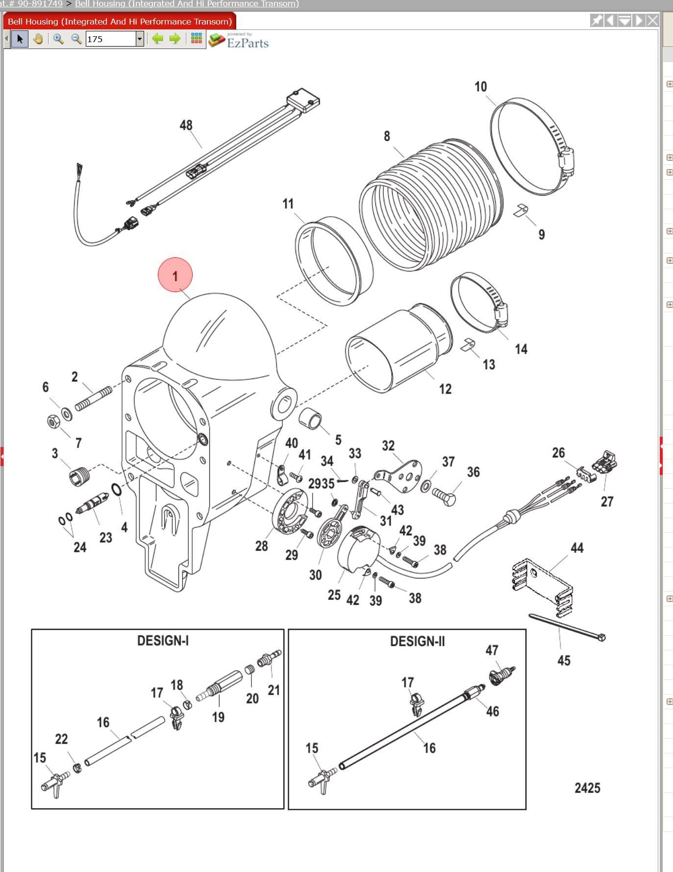

Use the Trim Switch bracket from the HP Trasnom and put the old analog sender in the bracket. Than you can use the old analog gauge with the HP Transom. (The 3 holes for the srews are always in the HP Trasnom)
