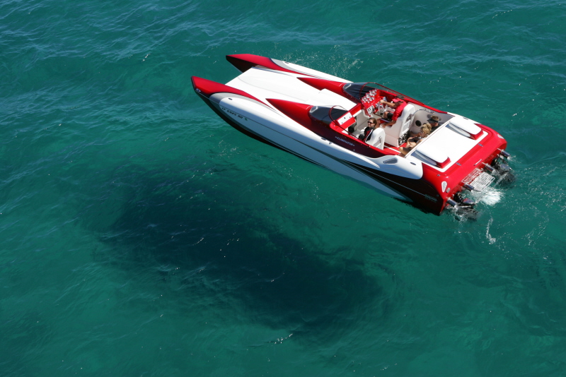

I also have a 2006 28' Daytona except mine has 525's in it. I don't know how much speed I am losing off of the top end by using 5 blades because I can't even get mine up on plane with 4 blades, probably because of the high X-dimension. With 2 people in the boat with 4 blades and the tab down all the way I just kept blowing out the props. I tried for a good half hour to get that thing on plane. With the 5 blades and 6 people, full gear, full tanks of gas the boat launches up on plane no problem. Top speed to date with the 5 blades is 112 m.p.h. Here's a few pics of mine.
