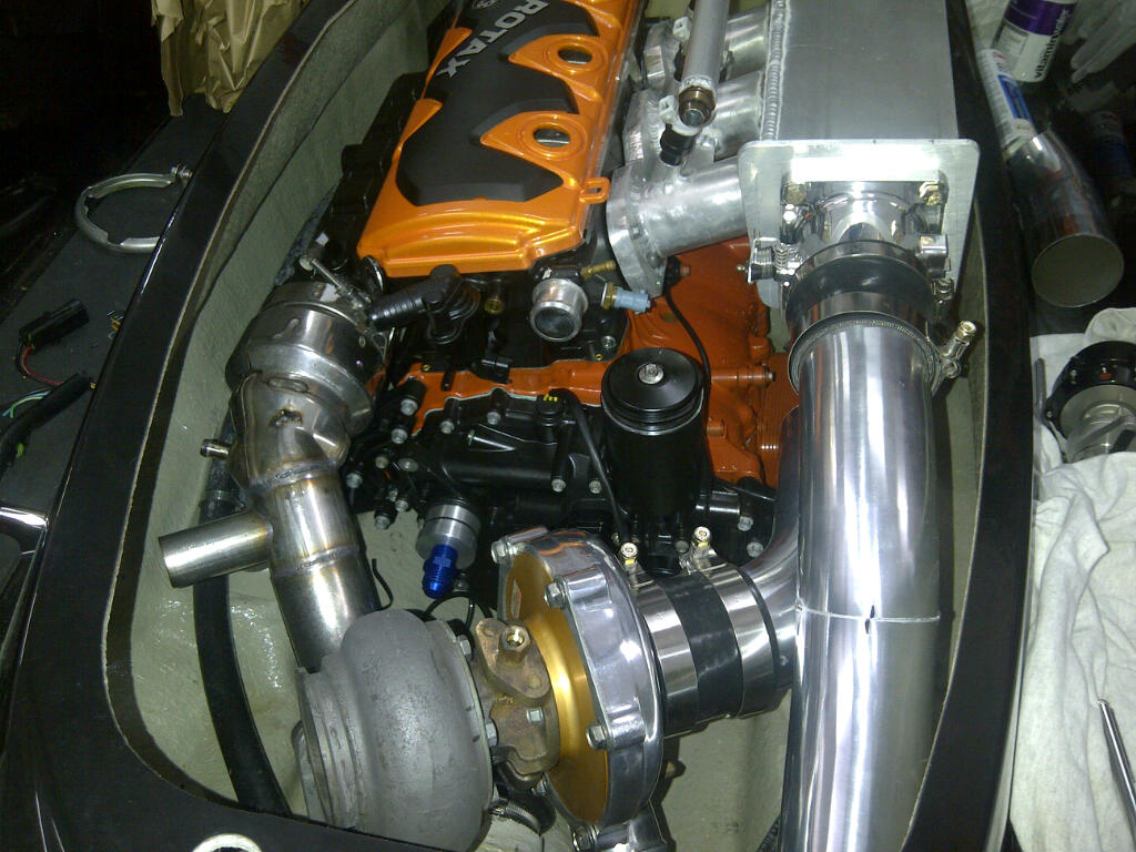

@catman01...Thanks...appreciate it..
@skydog....Keep up the good work yourself...and I got a few customers with some pretty radical STI's that I built...
@bdubs...it has been a while and yes the 2J is an amazing motor, that engine in my boat has been thru some serious trial and errors and its still the original parts and components that were installed from day 1...over winter I do plan on going thru it just top be sure everything is on the up and up. As far as the heat question, the wrap is ok, I just built a smaller style exhaust manifold which I do plan on water cooling...
@GPM....Yes I do my own wrenching...everything from design and blueprinting, to cylinder head porting, engine building and all custom fabrication is done by myself...as far as HP ive never dynoed it...I have spoken to my local machine shop to see if we can definitely do it one of these days...but in some sort of estimate I would say in the 950-1000hp range...dont hold mee to it, thats an educated guess based on speed and boat size, weight, gearing, prop pitch etc, etc, etc...
@engineermike...I do plan on water jacketing the complete exhaust...I did just fabricate a smaller exhaust manifold to do so...but had ran out of time prior to the LOTO Shootout and had to assemble it to m ake the race...hopefully soon I can get to it....And those turbo ski's are taking off...got one that im working on now as well...
Attached Thumbnails PSIRacing 6 cylinder turbo Eliminator 25-img-20110726-00164.jpg
Awesome! Mine was also an RXP. I first installed a T3-60, then later upgraded to a GT32.
