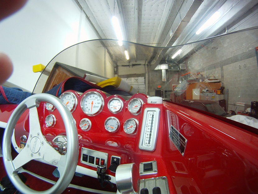

@Scarab63....Im hoping to test sunday and I got the GO pro already mounted so I dont forget this time...I have it pointed at the dash and out the drivers windscreen so everyone will be able to see whats going on with Gauges...Hopefully I make sunday, if not next week for sure!!

Heres an idea of what view the video will be, I might get another one for a rear shot as well....
Thanks,
B
Thanks,
B
Nice buddy!! 130mph here we come!! Got to love Daytona!!! U ever run meth before man? I am able to run crazy boost 35psi on pump in sled with zero knock!!
