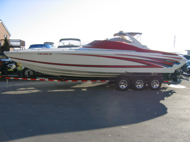

Old 08-30-2006 | 07:03 AM
K-MAN's Avatar
Joined: Apr 2001
Posts: 63
From: Nashotah, WI
Default Re: Back In The Water Again!........
Here it is!
454's MPI's, 310HP, Bravo One Drives, 1.65 Ratio, 4 Blade 28 Pitch Prop
Guessing She'll Run About Low to Mid 60's?
K-MAN is offline
