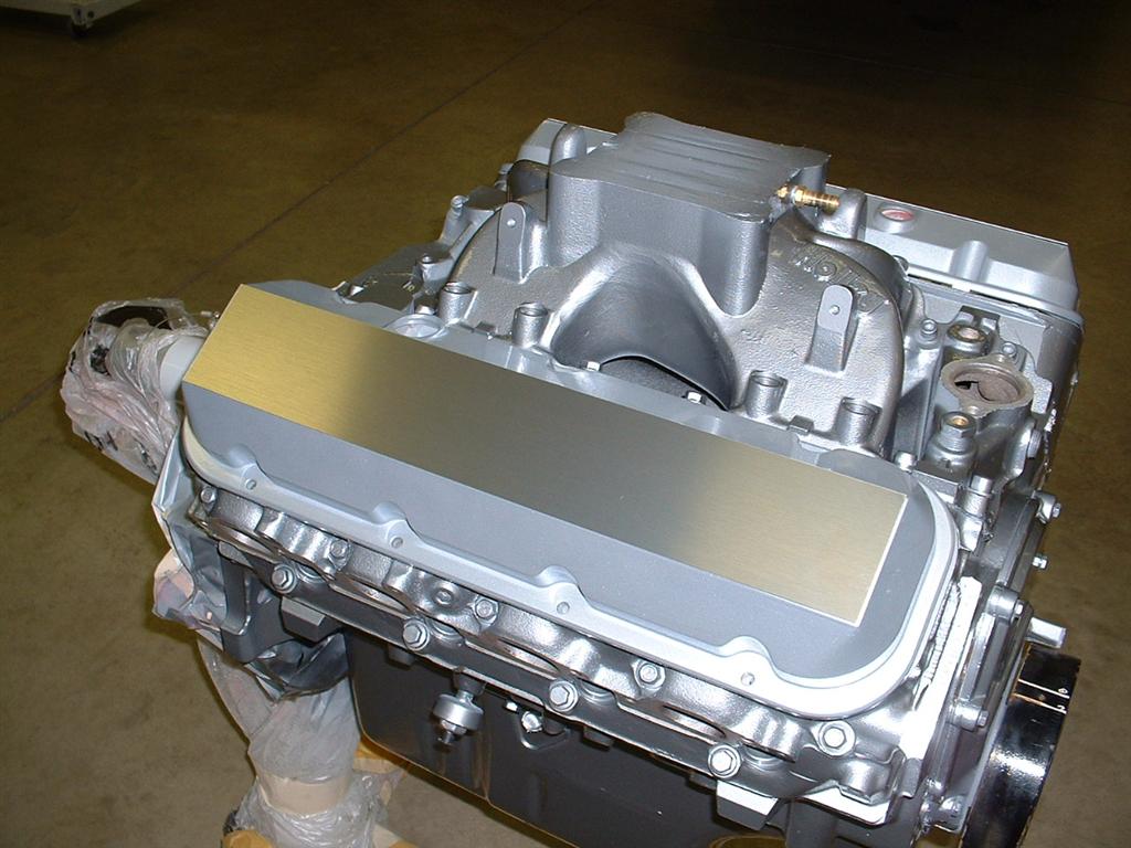

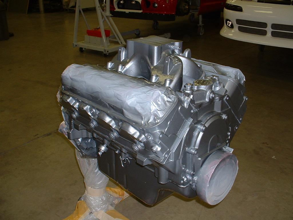

First engine's out of the paint shop! It's looking a little like the Silver Surfer at the moment, but all the accessories and brackets will be black. The nicest thing now is that when I pick up a ratchet out of the toolbox, it's set to "On' instead of "Off"...
Attached Thumbnails Project......382-dscf0054-large-.jpg   Project......382-dscf0057-large-.jpg   Project......382-dscf0068-large-.jpg
