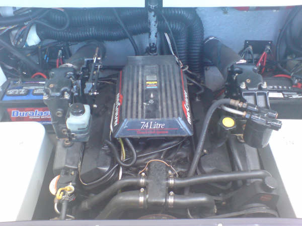

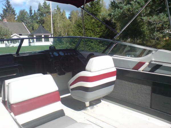

The boat is a 1988 242 SS appart from stringer/stern seems
to be in nice condition. The engine is a 1997 454 330 hp in good condition.
