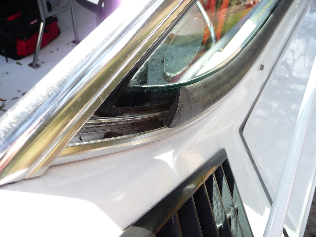

Are the screws under the Rubber Gasket? So you pull the Gasket , remove the screws and then you could remove the entire Assembly? Is it leaking between the frame and the weather stripping?
What I would like to have is a new rubber Gasket ..... I cant believe its not available or at least there isn't someone that could make some up ....Maybe if we bought 10 sets ? ........m
Attached Thumbnails re-setting the windsheild-p1000369s.jpg   re-setting the windsheild-p1000373s.jpg
