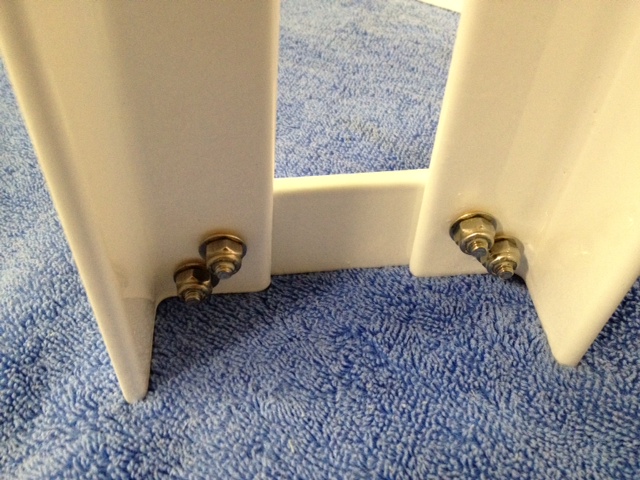

I figured unprotected (non-plated) aluminum structure and stainless screws combined with moisture (fresh or salt) caused most of this corrosion. I'm adding these Polyelastomer Cushioning and Sealing Washers .060" thick against the powder coated parts. Generally it will be:
Screwhead > SS Flat Washer > Poly Washer > Part > Poly Washer > Part > Poly Washer > SS Flat Washer > SS Locking Nut

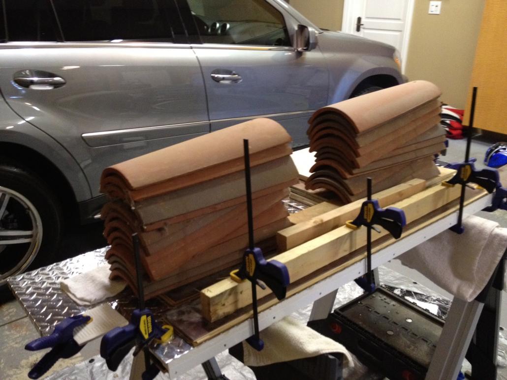

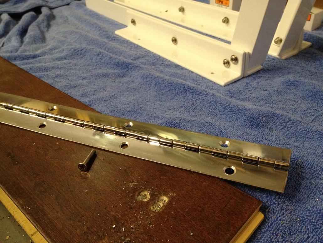

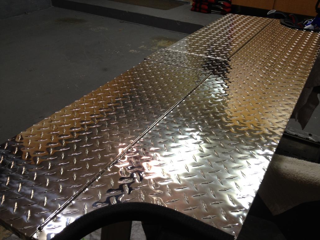

Assembly Time! Trying to get it done and delivered tomorrow. Engines go in next week.
Attached Thumbnails Put the bird in a nest-1.jpg   Put the bird in a nest-4.jpg   Put the bird in a nest-5.jpg

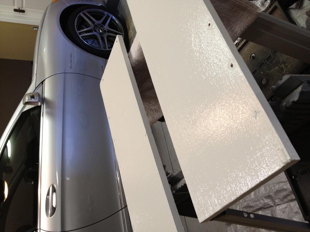

Getting it done. I have to go modify the "T" part right now before I install that. Need to relief the hinge area more.
Attached Thumbnails Put the bird in a nest-10.jpg   Put the bird in a nest-11.jpg   Put the bird in a nest-12.jpg

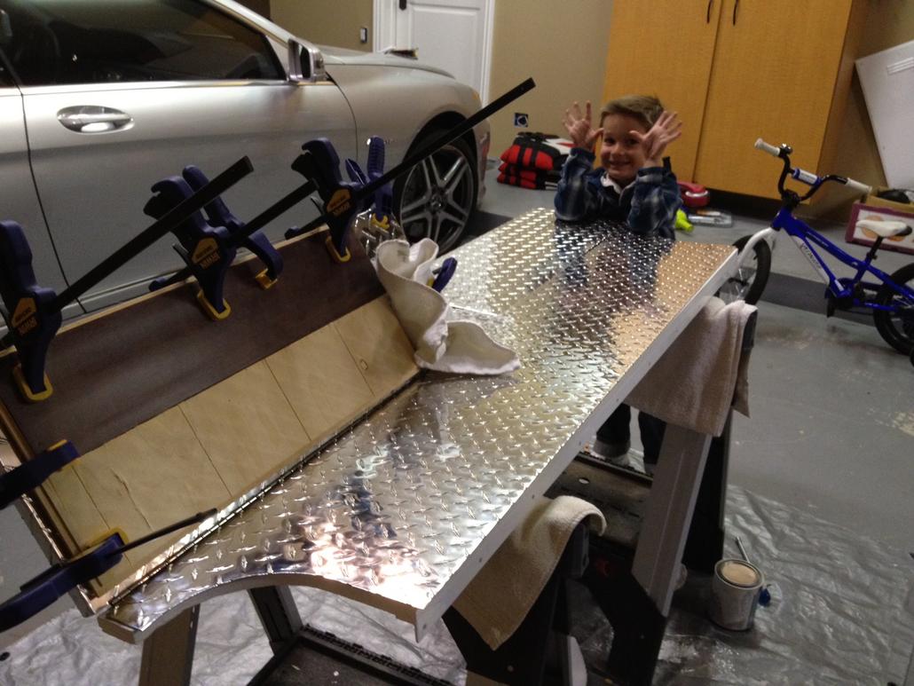

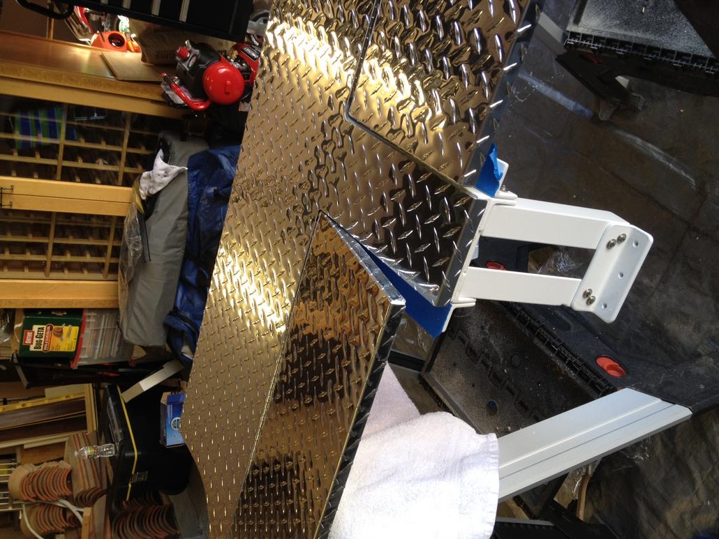

All fixed. Watching glue dry now.
Attached Thumbnails Put the bird in a nest-20.jpg   Put the bird in a nest-21.jpg   Put the bird in a nest-22.jpg

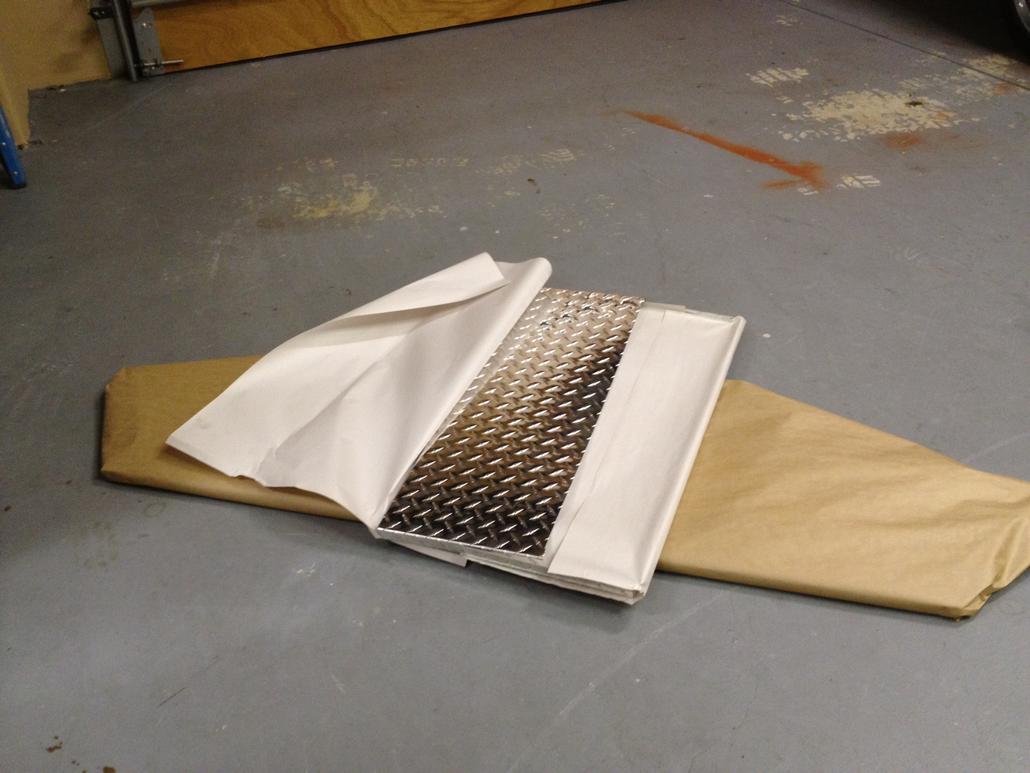

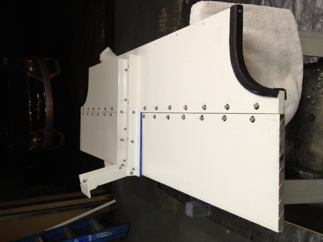

All done......delivering today! A nice improvement!
Attached Thumbnails Put the bird in a nest-1.jpg   Put the bird in a nest-30.jpg   Put the bird in a nest-31.jpg
