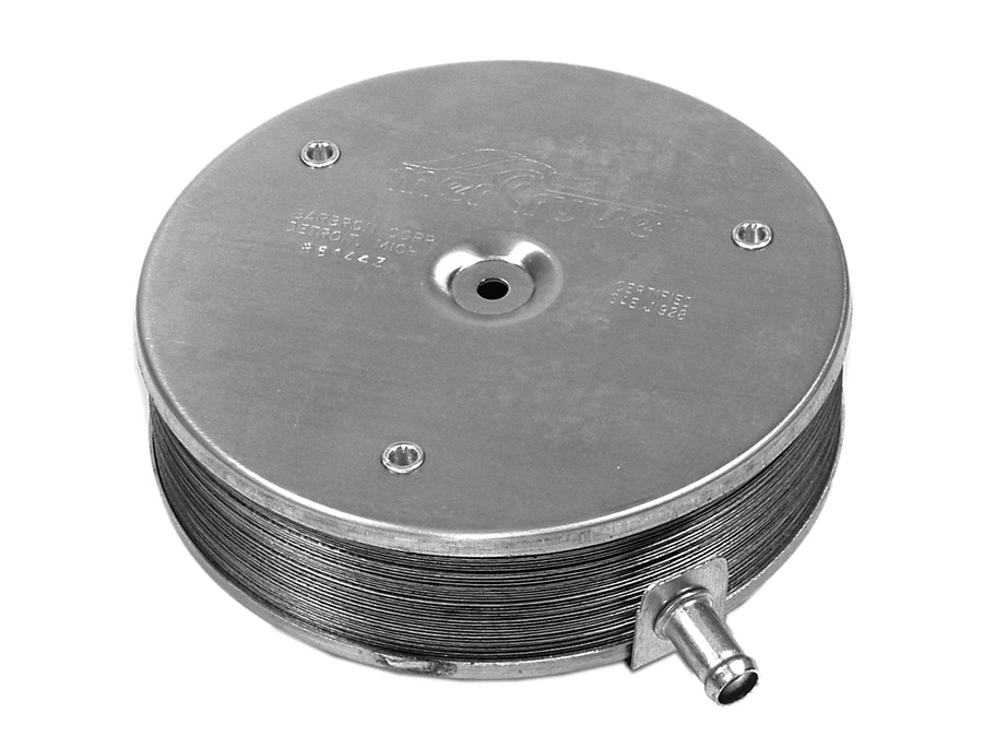

This is a maybe.........
Photo just above (post #55) of the 'Unconstrictor' appears by looks to be just like Mercruiser #861443T
1st photo: The Unconstrictor sold on ebay. No longer available as the seller just had a certain quantity years back.
It's very possible the Unconstrictor decal is placed over the manufacturer and part # stamped in arrestor as this is an old repackaging trick. If someone has one, would you be willing to verify ?
2nd Photo : Mercruiser #861443T (notice it has stamped on top 'Barbron' and appears (try to read # on photo) to have Barbron Part #61443. These are availble thru Mercruiser for purchase.
3rd Photo: Mallory Marine says 9-31105 is a replacement for Merc #861443T. but no longer available..but it is..see next line
Sierra's parent company bought Mallory. Sierra's part # should be 18-31105 if they make/sell these but I can't find them yet.
2.05 element height / 7" Diameter / 3.95 " throat (mounting) / 2.975" overall Height
Again, the Mallory FA's are shown here : https://issuu.com/marinedirect/docs/mallory/224
And there dimension's are shown here: https://issuu.com/marinedirect/docs/mallory/224

Originally Posted by SB
To try to get my info straight, you have what I show below and they where made by Barbron ?
Similar but no center hole. It was the same name. It is the same design as the blue CP one.
