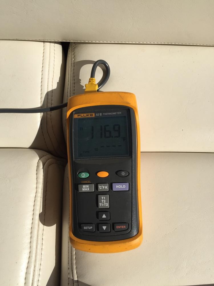

[ATTACH=CONFIG]558029[/ATTACH]

I placed the probe between both engines just to get an idea of bilge temps, next test would be to place it next to flame arrest or to see what in,et temps are.
