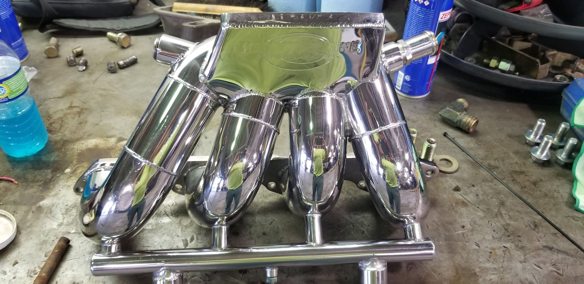

Done a little rubbing on one of the headers yesterday before I had to go work on the shrimp boat.

Still waiting on the pistons to arrive. I need to go get the oil pan and do my drain plug/hose I want to make. May have a friend powder coat the intake silver so I dont have to worry about the aluminum oxidizing.

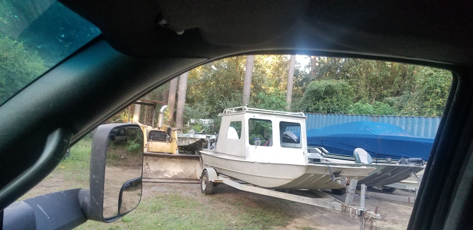

Been building this guy up for hunting season. Has a 115 yamaha on it. Been playing with props after building carbs and fresh plugs. Got 44mph today art 5500rpm. Not bad for what it is. Plan to get it all cleaned up and painted green/camo in the next few weeks.
