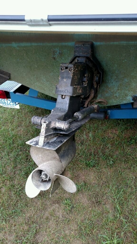

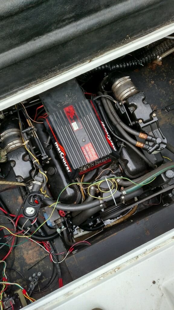

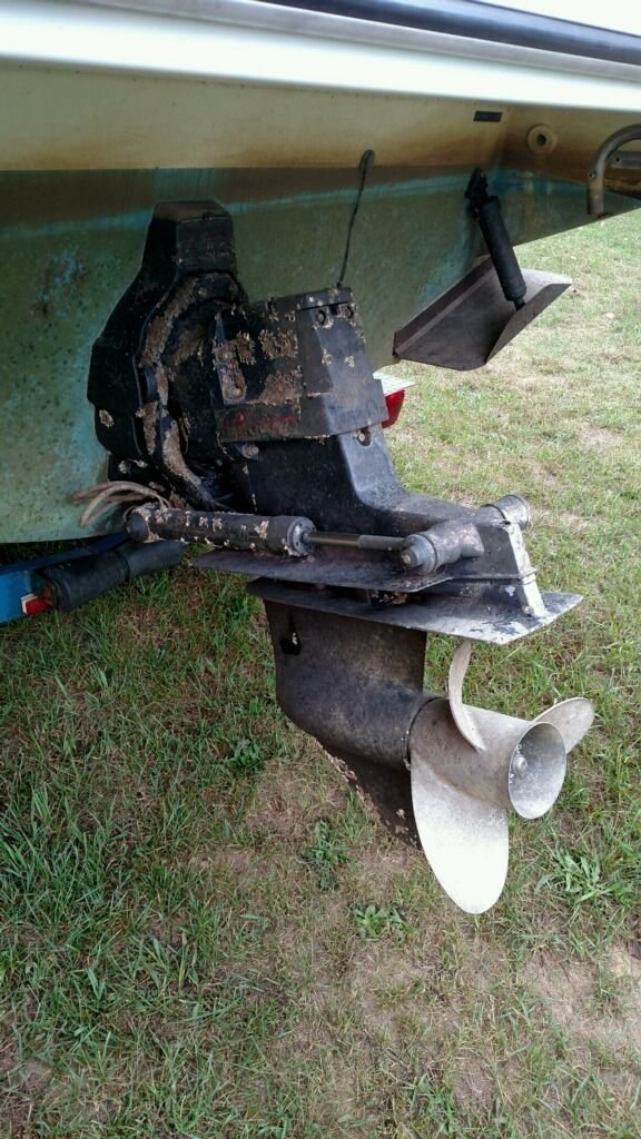

Ok, here are the pictures. Motor looks decent, outdrive obviously sat in the water for quite some time. What can you guys tell me about it?

1989 7.4L 330 Bravo 1. Uses the drive reservoir set-up so that’s a plus.
The engine looks clean, and the drive not too bad (clean it up and repaint).
Check oil on both. You’ll want to drain some out of the leg to inspect for shavings and such. Having the drive gone through and resealed wouldn’t be bad.
Transom assembly will probably need a refresh (but that’s necessary on all of them). Replace the swivel pins and bushings (much easier to do off the boat). New bellows and gimbal bearings.
On the engine if you can get a compression test, that’ll be good knowledge to have. What’s up with rocker switch? What’s the boat and how many hours?
You’ll want to go through the exhaust. Fresh water isn’t bad, but any level of salt exposure will probably require replacement.

Tom I normally agree with you, but, on this one I say run don't walk.
As for this being an oiler? I don't think so.
