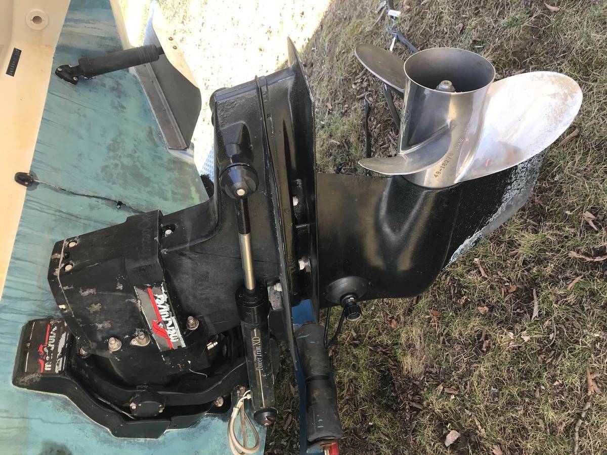

Seller says this is a bravo 2 but it sure looks like a bravo one. I can see where the label was and it looks like bravo one. Can anyone confirm?

Yes that's a B1 with a 15.5 inch x 17P prop. B2 props are in the 17 inch and larger diameter

What year? I ask because you want one with an oil reservoir in the transom. The earlier ones did dot have any oil passages from upper to lower and therefore have inferior oiling characters. ][One easy way to tell is if the holes where the lift rams go through the back of the drive are round or oblong. Also if drain plug on bottom side of lower is VERY early, again avoid.
Oblong=newer, good round=old, avoid.
How big of a hurry are you in? What is your price threshold?
This unit does not look very well cared for.

its a 1990 x 600 hrs. Freshwater. With 7.4 I’m thinking I can get it for $3500 or less.
