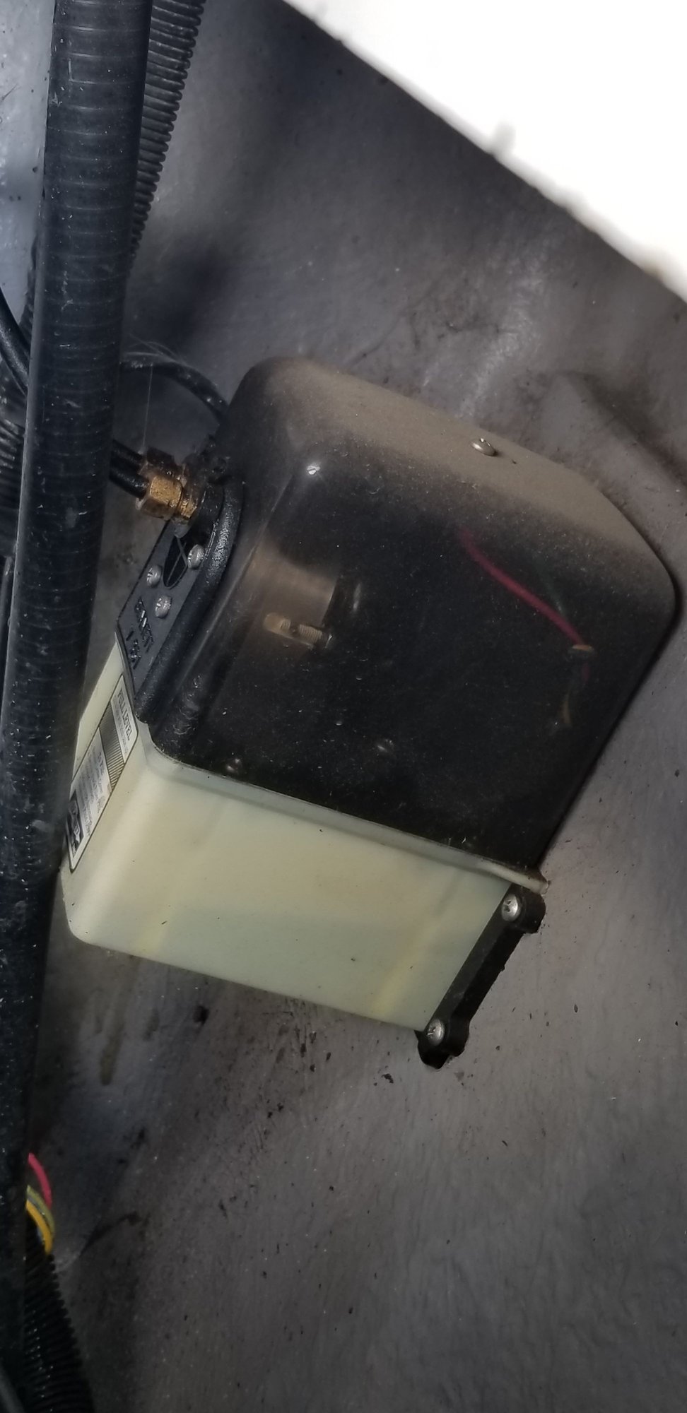

Looks like below pic and usually (not always) mounted on floor in each (if 2 drives) corner of engine compartment.

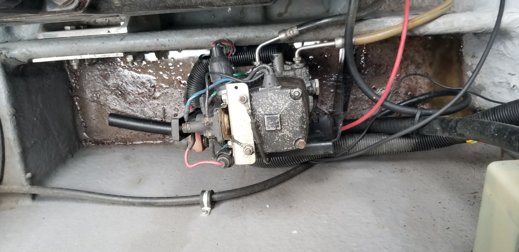

Okay, Guys. I removed my engine cover to clean some things up last night, and I located the trim pumps. They do not look like the one pictured above. I took the best photos I could. Can you guys give me some advice on these?
I am assuming the screw I see is a filler/dipstick. I don't see a visible way to determine fluid level, or a spot for a filter/screen.

And just to be clear, the pump works, but that side is WAY slower than the other.
Is there a reason each drive is on a separate switch? I assumed to help adjust the way the boat rides, but I thought the trim tabs or K planes would do that?
