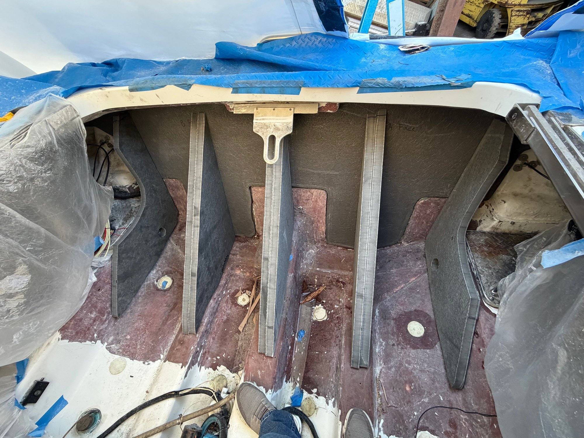

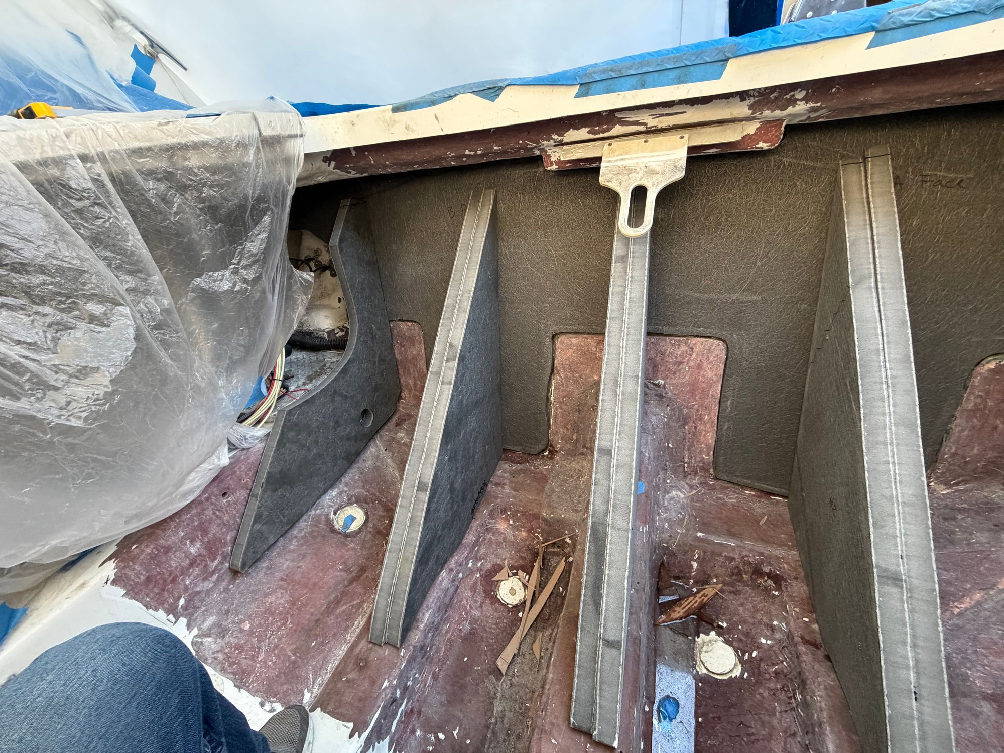

I finally getting some work done since the weather was nice yesterday.
Epoxy a 3/4” to the transom to make the back completely flat. This making the transom 3” thick. Also I am finalizing the size of the knees and going to get those in this week. For the knees I’m doing 5 total knees and they are 3” thick for the middle 3 and 1.5” thick on the outside ones.

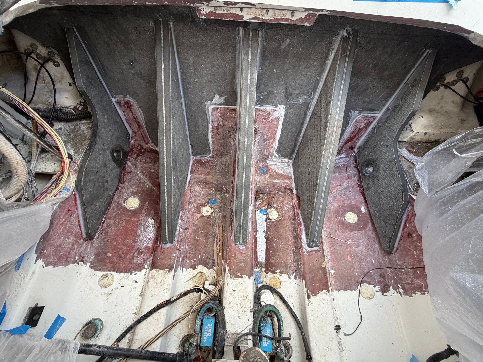

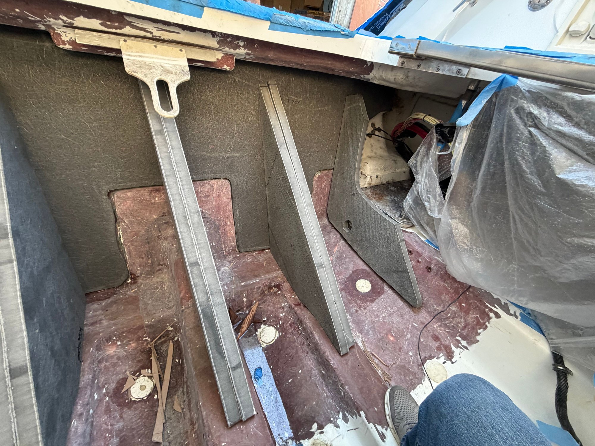

Inside knees mounted. Outside holes filled. Still have glasswork to do.
