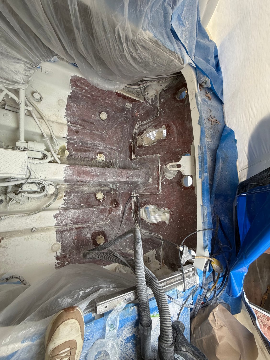

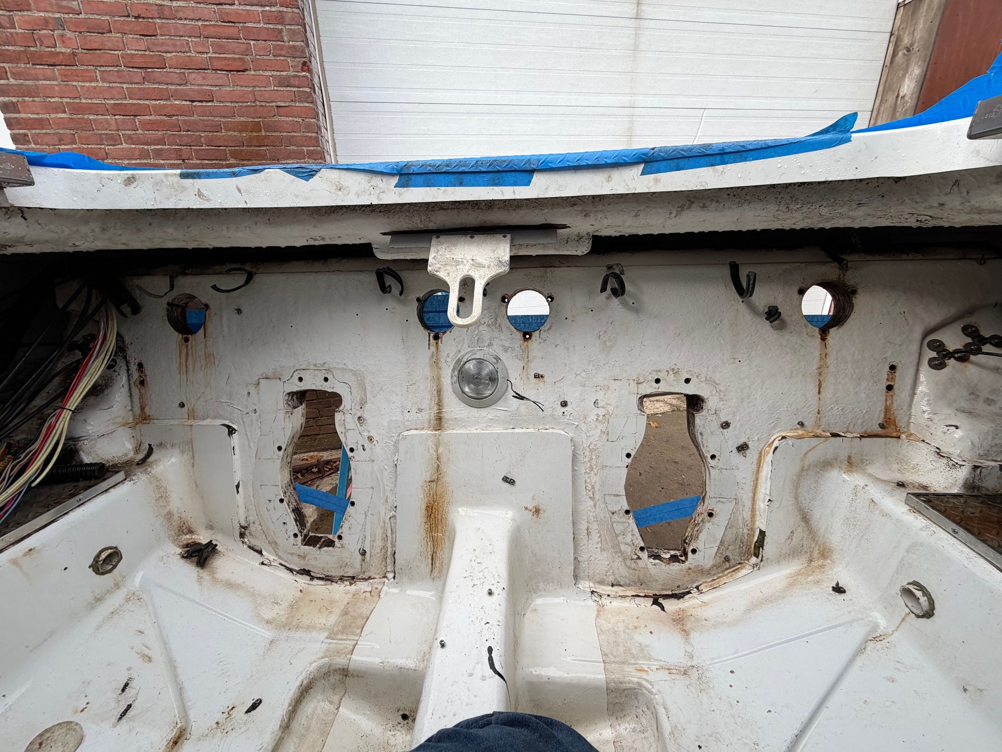

Got the cockpit grinder out to bear fiberglass. Have a little bit more cleaning up to do but also ready for template of the Coosa board.
going to put 5 knees tying from existing stringers to the transom. Also a shelf to connect the knees on a horizontal plane.
before the knees, going to lay a full sheet of 3/4” on the transom to flatten it out and beef it up a bit. I’ll tie in the sidewalls and deck with that 3/4” piece as well. This will make the transom close to 3” thick. After that, from the outside plug the holes.
the knees will be 3” wide (2-1.5” coosa). They will come out roughly 24” from the transom kind of a triangle shape.
hope to fiberglass probably February or March due to weather. Swim platform is coming from Armstrong, 100” custom, coming out 36” and 110” wide. That will
be finalized in 2 weeks and here by March.
