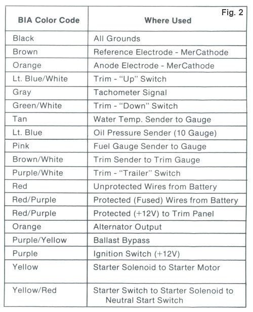

I just bought a 2002 292 and in the starboard gunnel I find these 2 plugs. 3 wires plus a purple wire that is not in the plug but has a bullet connector. Prior owner has no idea what they are. They have tape on them labeled port and starboard. wondering if anyone has a clue what these may have come from or what they go to. I haven't found the other end yet so I'm at a loss.

Secondary trim switch

Yup.
light blue/white is trim up
green/white is trim down
SB is offline

Okay guys. What is a "secondary" trim switch? Cause my drives and tabs both work fine, up and down.
