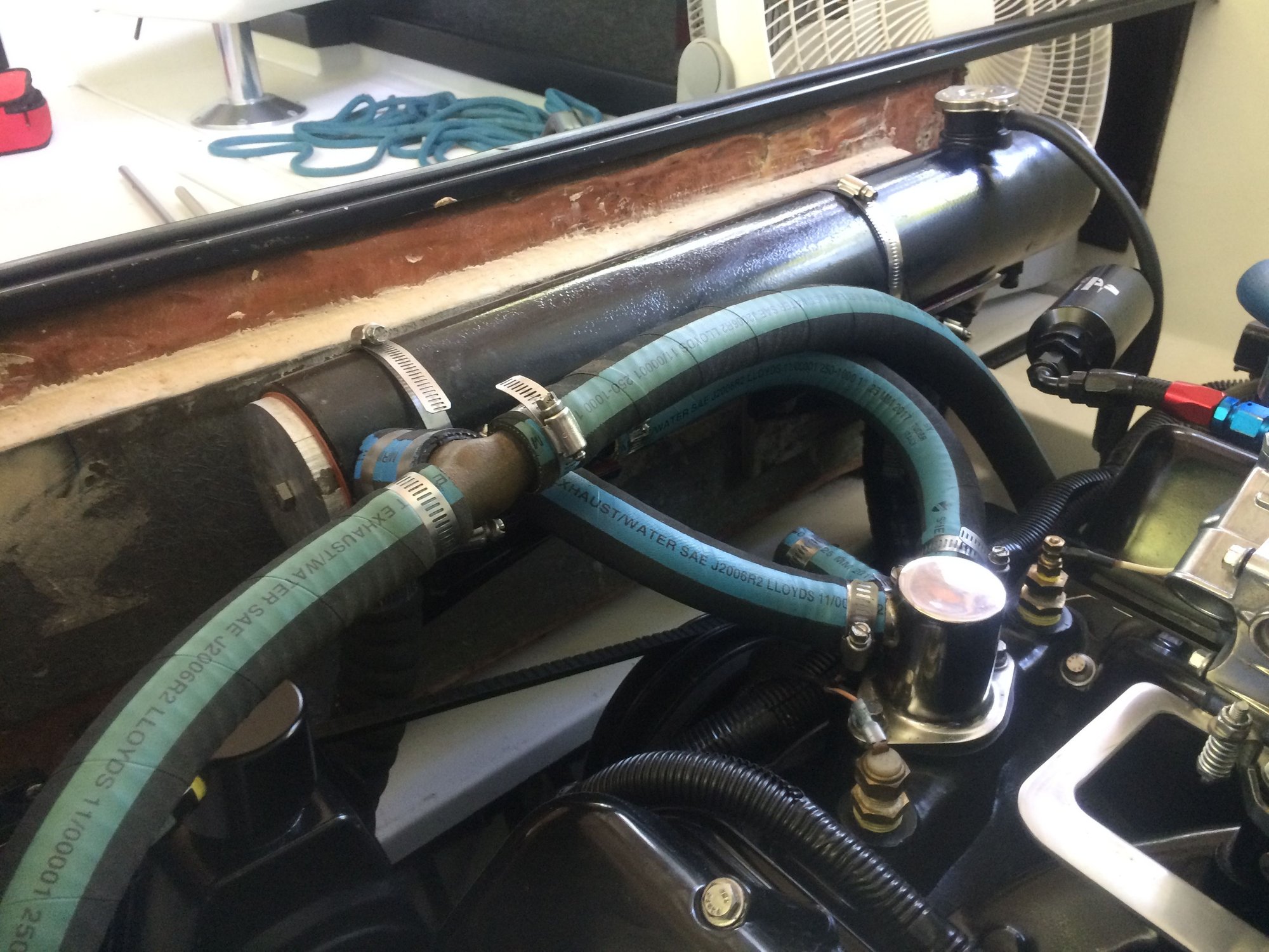

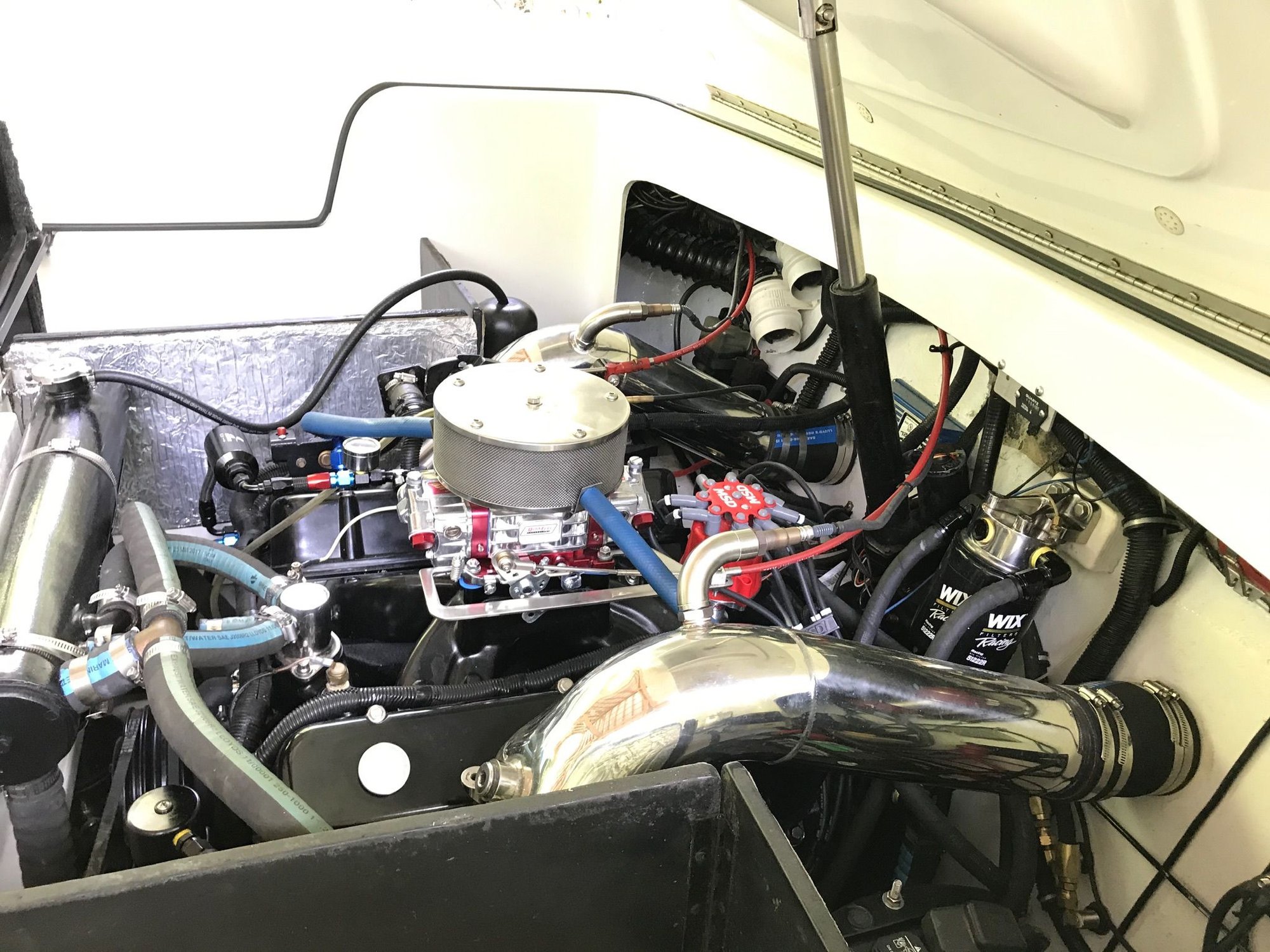

Here are a few bad pictures of the heat exchanger that I mounted on the forward bulkhead instead of engine mount. I built out the bulkhead to strengthen it for secure fastening. I have since painted the bulkhead and added a catch can.
Roscoe, these are great! Much appreciated. The ones I’ve been looking at have a two part tank (expansion?). Kits that are out there seem to use these (the one you have) with remote expansion tanks similar to yours so I think I’ll start going in that direction. New, these are not that bad price-wise but I’m keeping my eye out for used just the same. Very helpful!

I’m sure your rigging will be much neater than mine. Ha... I just wanted to show you what I did for $200 plus hoses and clamps. It’s great to know salt water will never touch any of those hard earned internals. Many of the heat exchangers have the Siamesed expansion tank and eliminate the need for a puke tank. I added the overflow because I was pushing some coolant out beneath the cap on hard runs. I replaced the rad. Cap at the same time and haven’t lost a drop since so I think my cap was the issue. I needed more crap in my crowded bilge anyway. It’s not sexy by any means but it sure works. Keep up the good work Tom

Now I am watching you guys do heat exchangers...and its got me thinking! Tom B (not Z).

It’s super simple Tom B. I would never have been without it if I had known how cheap and easy it is to install.
