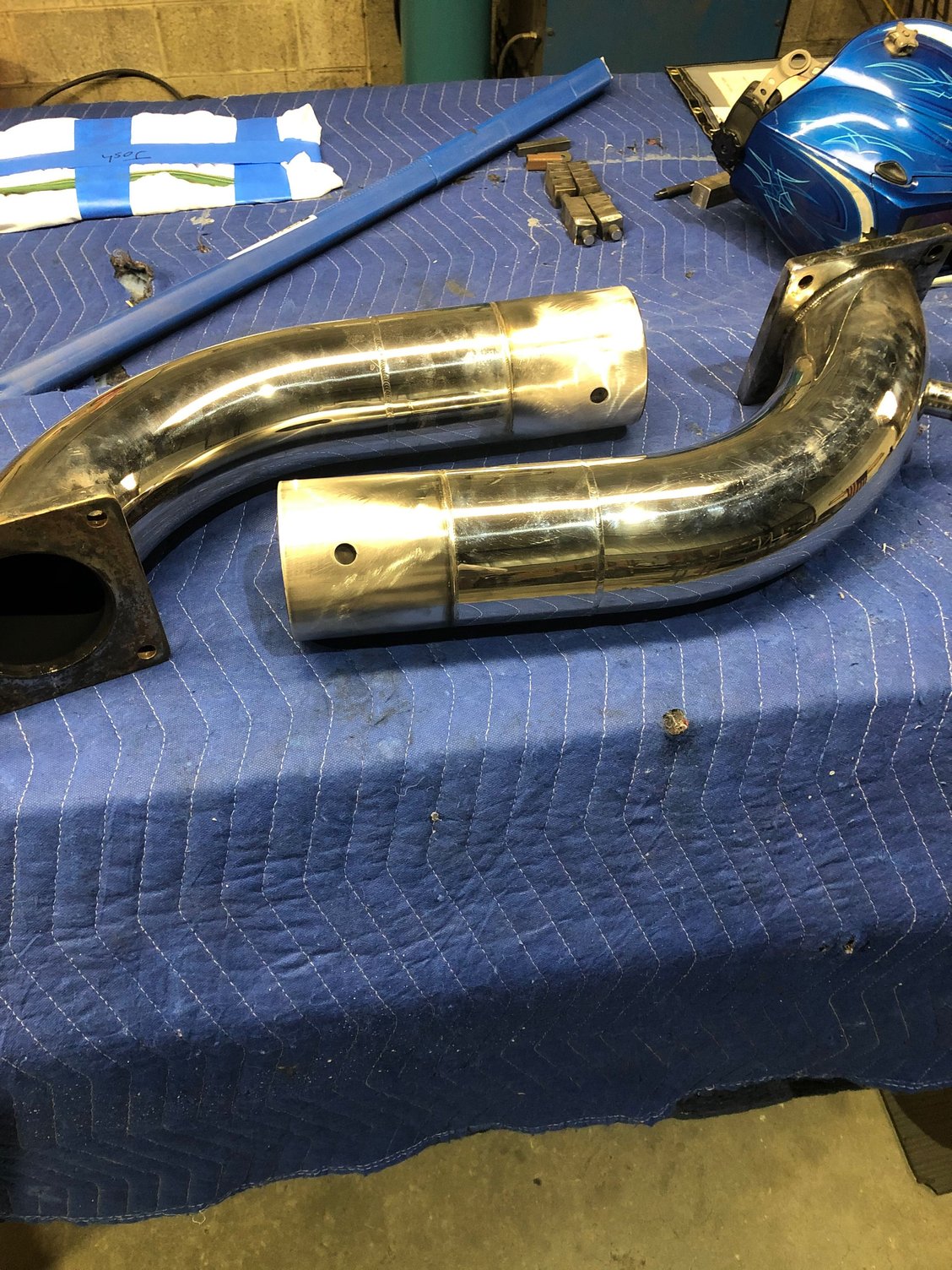

Muffler delete complete.....

I think those Lightnings are looking pretty good there my friend! These Gil pipes just seem a little weird to me.
Yes Tom, definitely odd. Like we were talking about yesterday, the inner and outer pipes meet at the end of the tail so the mad scientist and I are trying to figure out how to correct that with me having to replace the whole exhaust system.
I think I figured it out last night while laying in bed, I just need to draw it up, I am thinking of tug welding the inner and outer pipes where they meet at the end of the tail, then welding in a stainless 4” to 3.5” reducer piece and a length of 3.5” pipe to get the inner pipe of the tail to the transom. Then I would slide a 4” piece of stainless tubing over that until it contacts the should of the 4” reducer then welding that seam. I would then plug the three factory water holes and weld a saddle bung to both outer pipe sections to connect the water via a small section of hose. This would give me dry exhaust to the thru hull tips and dump the water prior to exit around the inner circumference.
