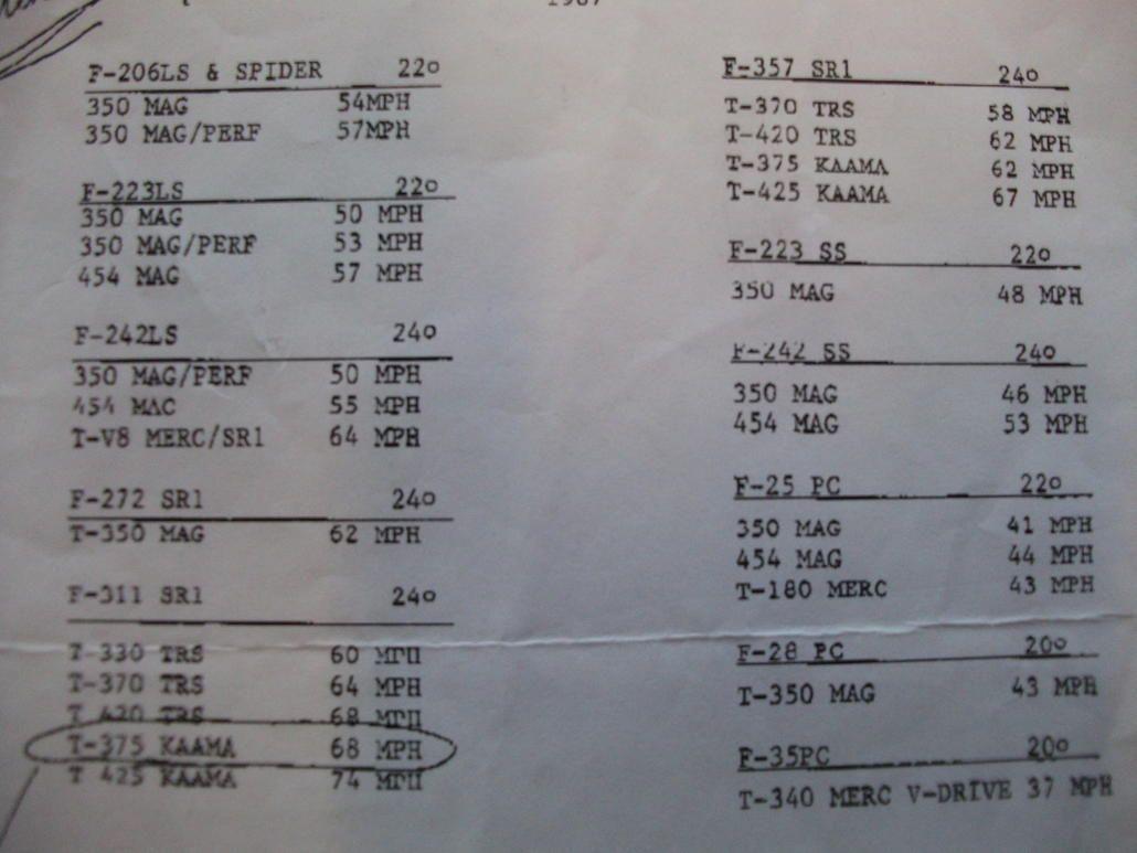

This may shed some light.
GLENAMY 242SS is offline

5 people that have/had 242's (Some in the 70-80 mph) have shared their thoughts, Can't wait to read his posts in late June. Some people "Just Know" and ask questions hoping some will tell them Good Idea.
Good Luck-Happy New Year
