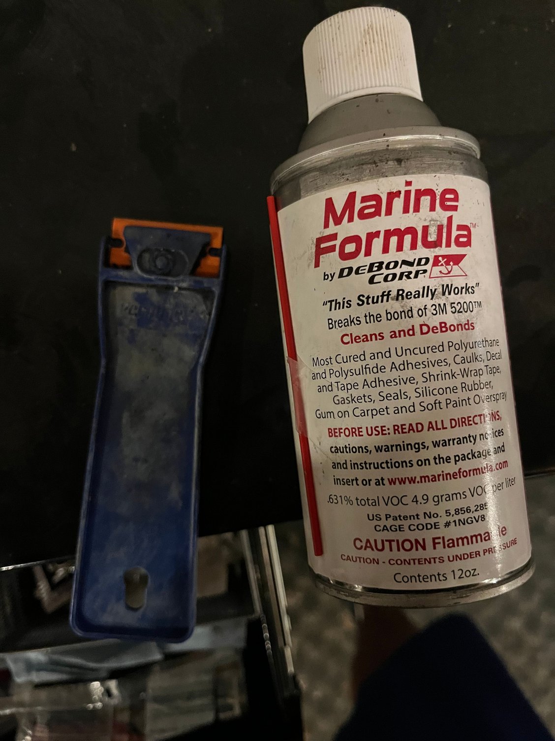

This combo is hard to beat. Debond is suppose to be safe on gel. I do small areas and neutralize the area shortly after. No issues so far. I never thought a plastic razor blade would be so handy. Used it to take all the old silicone off around my old windshield, some decals and numbers off my jetski, and more. Much better that goo gone or whatever Walmart sells. Debond isn’t cheap but it’s worth it.

I’m near 300yrs old and I never heard of this. Thank you. :thumbs
