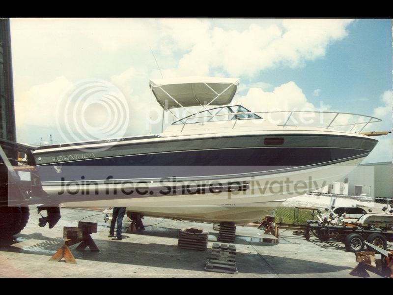

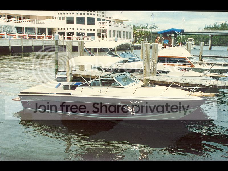

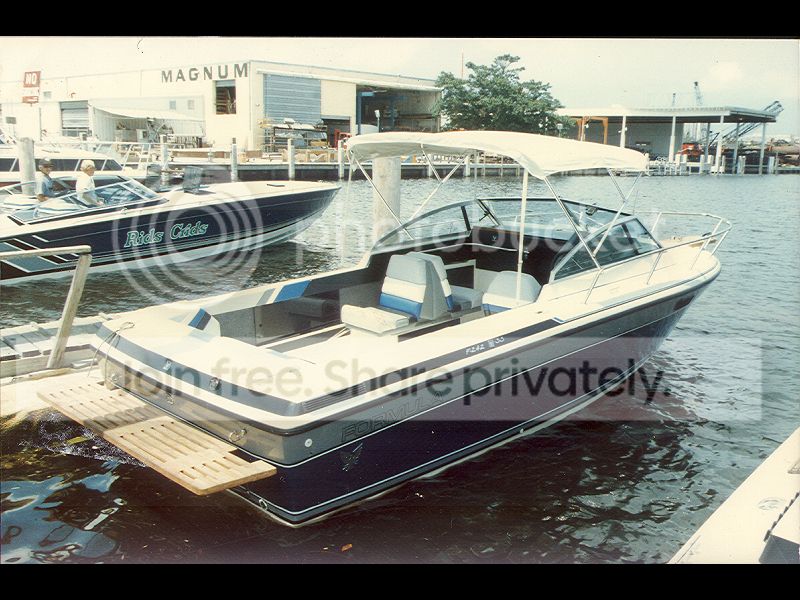

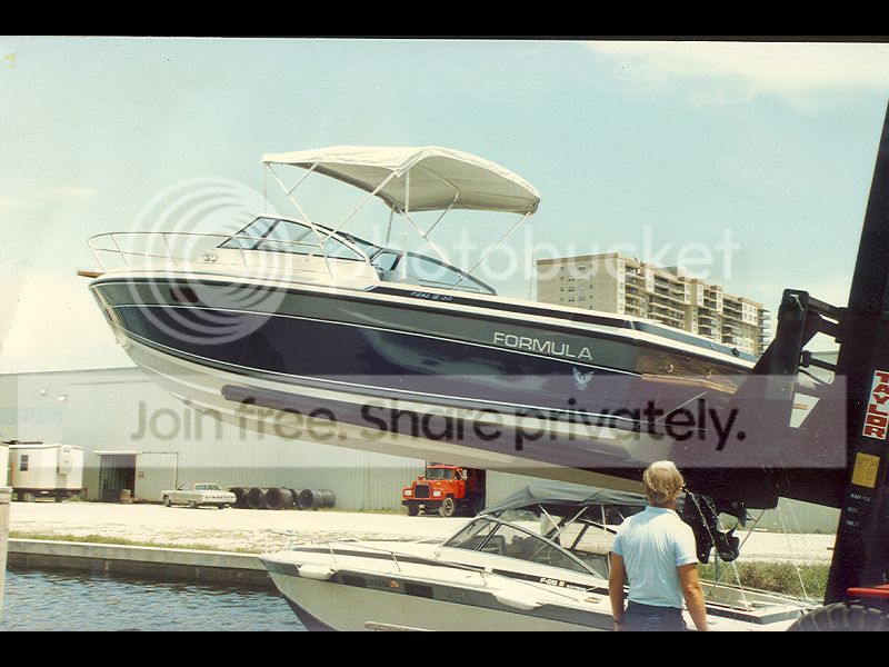

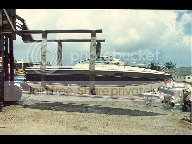

I had a new 1986 242 SS...sold it to buy my '86 272 LS. The guy I sold it to still has it and replaced the original 260/Alpha I with a 425 Horse Mercruiser 383 Scorpion and Bravo I drive. The boat is almost as nice now as it was when I sold it to him in '86. He runs from Ft. pierce to West End in the Bahamas several times a year and claims his will cruise all day at 50~55 and tops out at 63-65 depending on the load. He runs a 25" Mirage + "labbed" and tells me it now has better range than it did with the single 260/Alpha I/ 19" Mirage.
The 242 SS formula is one of the most under rated and most useful boat they ever made. I would love to have another one...they are great overnight boats when equipped with full cockpit canvas. I have seen a few 242 SS on OSO with strong 502/Bravo I propulsion systems that run into the 70's with the ability to pull low speed skiers and tubes all day.
I watched my boat go thru the Miami Plant each step of the way and can tell you there is no difference between a 242 LS and a 242 SS from the Rub Rail down. that model was one of the first ones set up with a complete one piece drop in top deck and inner liner.

Note the high free board in the last pic. For you guys that are "NE 188th Street" history buffs...these pics (except the last one) were taken in August of '86 the day I took delivery at High Lift Marine in North Miami Beach. Note Magnum Marine and part of the Cigarette factory in the background.

That must have been a great day, I did notice right away the Magnum sign and the Cig factory next to each other. That`s a lot of history right there
