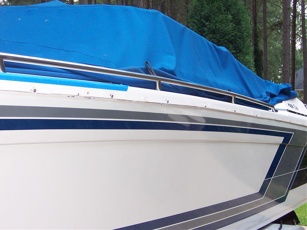

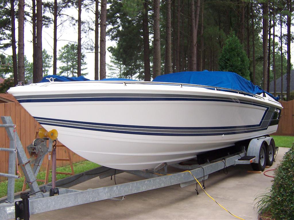

Pulled the factory black rub rail off and replaced it with Taco's 2 piece Rigid base and vinyl insert. Very time consuming but worth it. Here are some pic's.

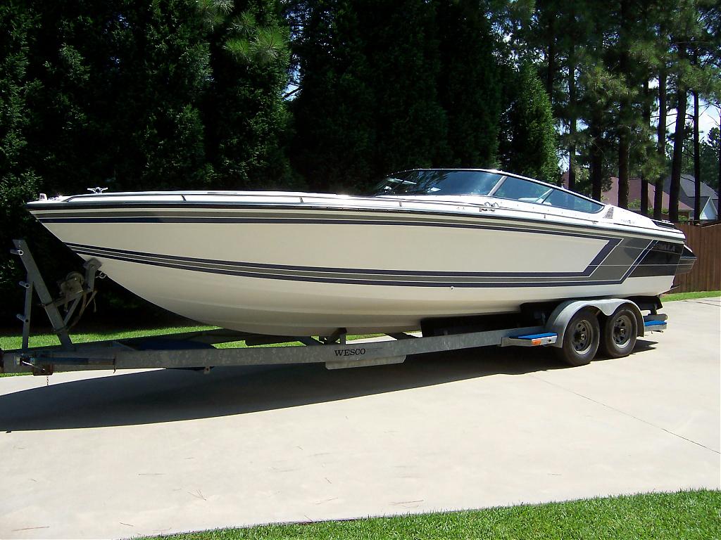

Here's a pic of the original black rub rail
