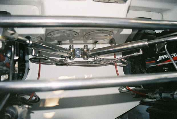

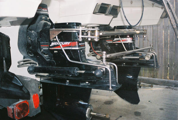

You won't be able to tilt all the way up as center mounted steering rams will hit the center pod of the ST. I have K-planes and no room to mount the rams outside the drives.
What about installing internal shims(stops) on the Trim Cylinders? This would limit total travel right?
Well , the tilt limit also varies if the drives are straight(greatest tilt) or if they are turned slightly(the least tilt room available)
Here's some pics from another 272 hyd.steering install
Attached Thumbnails The complete 272 thread-holes-medium-.jpg   The complete 272 thread-installxs-medium-.jpg   The complete 272 thread-closetotop-medium-.jpg
