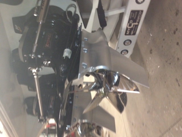

Just got home from getting my boat back. Ended up with gaining 5 mph. Old set up was p5x hydros 29 pitch on xrs 5500 rpm 88 mph, new set up 30 pitch herings scx-4 5300 rpm 93 mph. Both these were made full of fuel and gear 3 people on board. I am currently over pitched but that is fine because this winter a few upgrades to motors will put me at my target rpm. Boat gets up on plane easy and runs straight and true. spent yesterday am on the water with Reggie and Rlll. Driving lesson from Sr. was great he sure has alot of little tricks.

Few more pics

Those drives look awesome. Glad to hear that you had such a positive experience.

Do you think it was worth the 4000. to have the lowers done ? they do look great though .
