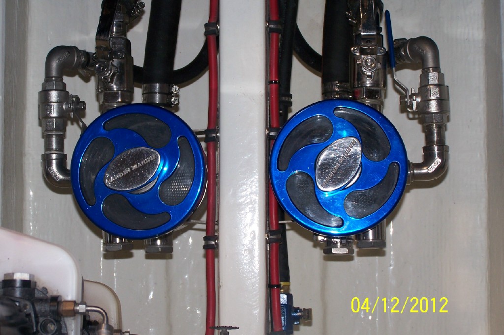

Hose connection is under the stern light. Here you go if you happen to have strainers.
Cap-N-Grumpy is offline

Mine looks identical to the second pic...appears to be "t"d into both. The second flush is on the port side and I'm pretty sure runs to the sink. Does anyone have a PDF with instructions on how to flush/run motors on land using this setup? I'm new to this setup...didn't think I had to use ear muffs with this and plus the front intake...but I guess you do??

DONE!!!, I wanted to mount the hose connection to be easily accessible from the cockpit. If the whole thing is by the transom it would be a lot of climbing back and forth to flush 2 engines. Here are a few pics to show location.
http://www2.snapfish.com/snapfish/th...NAME=snapfish/
