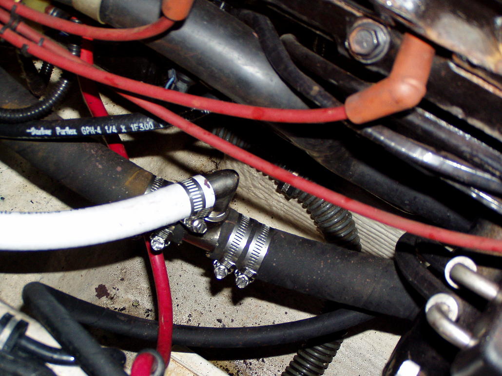

Just install a tee in the supply hose right before the seawater pump and run a hardwall hose to a garden hose connection, like your freshwater tank fill, mounted at a convienemt location. No valves needed. Flushes your drive and then your motor just by starting the motor. Also makes winterizing a 2 min process! Works great and doesn't look like the Menards option that comes from factory.
It's so simple it's amazing. I mounted my hose connector right next to the tank fill, and same location for other motor
Just can't use it to flush motors while boat is in water

Doesn't get any easier or cleaner than this. The white hose goes from that tee and directly to the connector. No valves, no nothing in between. The hose connector on left is for the port motor. Right is water tank fill. SB motor connector on other side of boat. I made the tees from SS
The last pics is Fountains setup I grabbed off the net. I guess it works better than it looks.

Also, seems like there is risk of a water leak at the water hose connection - due to no valve. If that'd happen, you'd be sunk right?? (no pun intended).
