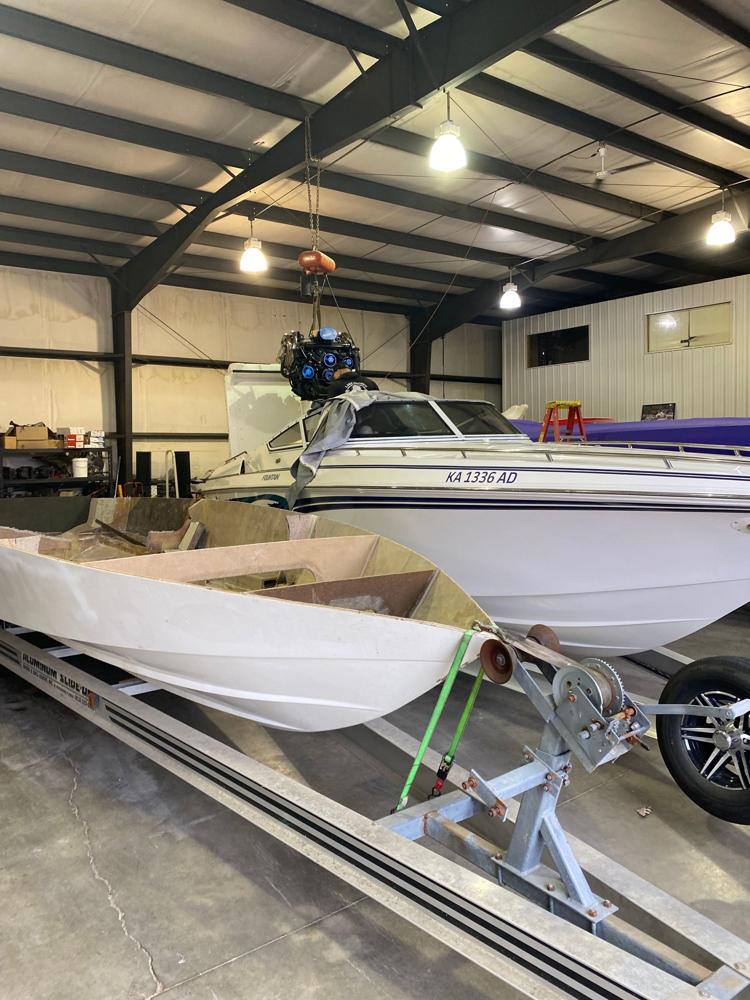

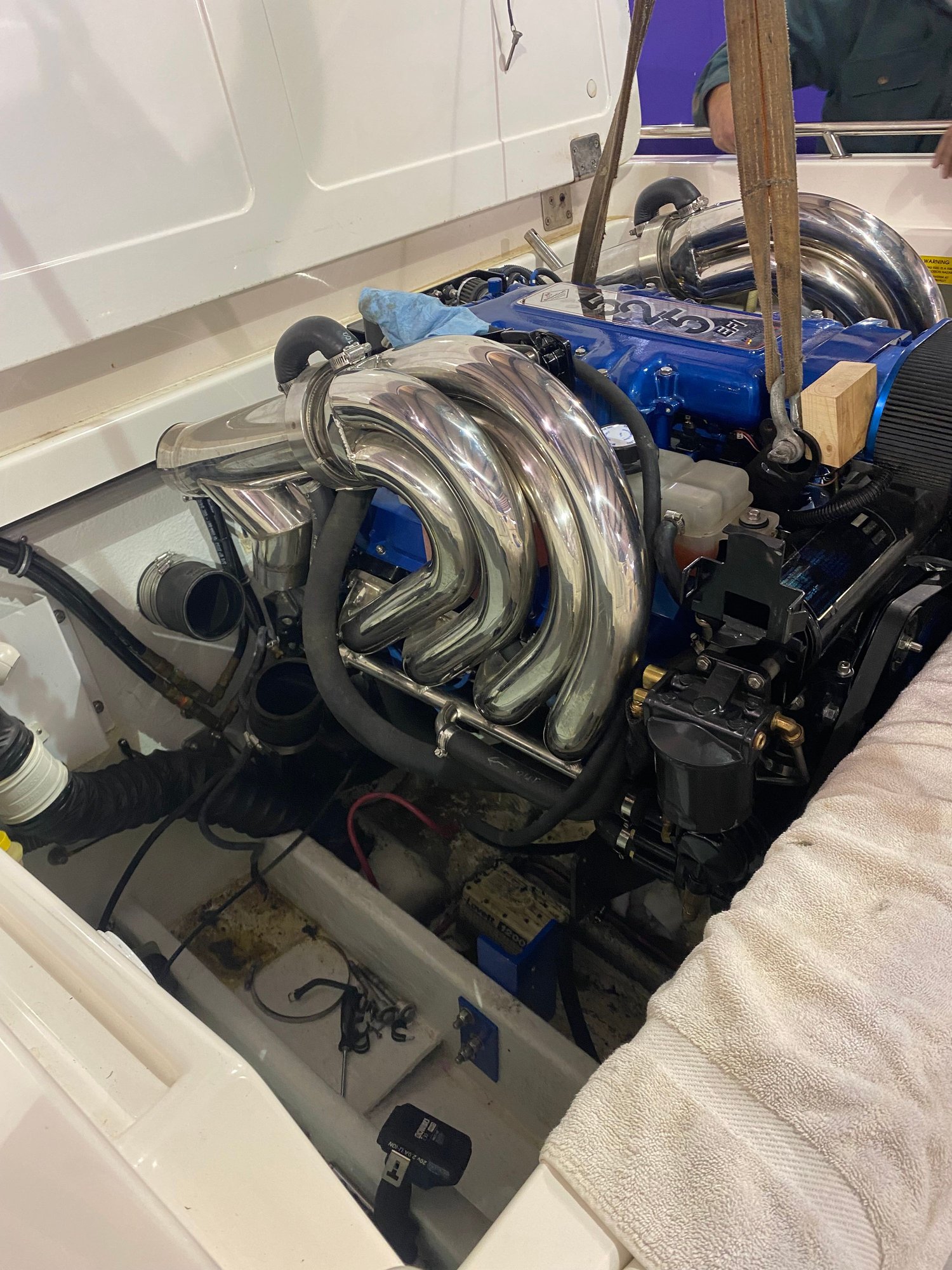

Had some fun yesterday. Going to take the engine to Wisconsin to get the top end rebuilt. I pressure tested the headers and they both tested good. Going to be doing a lot of cleanup and fix several small items in the bilge while the engine is out. Going to take the mufflers off and put some new exhaust tips. Hopefully it is all back together by spring.

why haul it all the way to WI to do top ends, one of the best cylinder head shops around here in the midwest, I've used them a bunch over the years on 500 and 525 rebuilds
