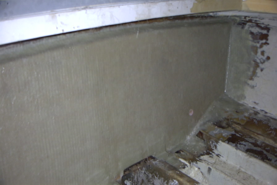

Here's an inside shot of my transom.
Much work left to do!
Leaving the engines at the same height ("X" dimension) will move the props up 2.5 inches.
The TRS is 2.5 inches longer than the bravo.
The TRS boats had the props pretty deep because the 4 blade bravo prop technology wasn't around.
So that actually works out nicel (if you run a 4 blade).
