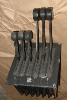

I bought a Kiefhaefer throttle control off Ebay that is a little weathered. I want to recoat it. Should I anodize it black or powder coat it satin black. Which one will hold up thru the years.
Here is a picture of it.

Like Too Old Said, anodizing doesn't hold up well in teh sun and you would also have to polich the whole thing first to get to look real good, the only real upside to anodizing is that if you scratch it, it won't spread like powdercoating can.

if your really concerned about protecting it, you should hard-coat anodize it then powder coat it. that would give you the best protection.
