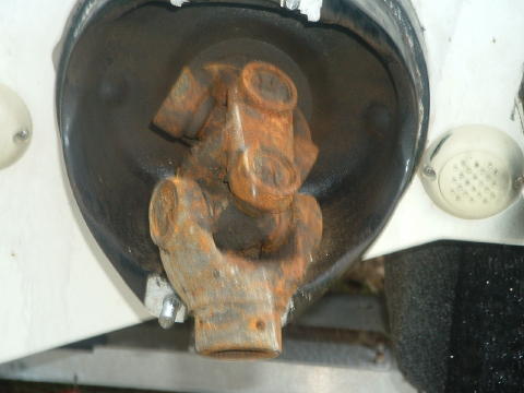

The ujoints on my Kaama's are Spicer. I can't remember the number. When I had the tranny out, I told them to replace the ujoint, he said there was no need, they showed no signs of wear, other than a little surface rust from a leaking boot that have since replaced.
