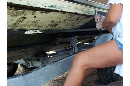

I scraped on this one for a day, and then rented a pressure washer with a sand blasting attachement. It worked much better, but be careful on covex corners, it's easy to eat through the gelcoat. It was on a trailer, so there was still a bunch I had to scrape and sand off later. Used 550 pounds of sand.
Never again, I don't care how good a deal I think the boat is.

Before.
