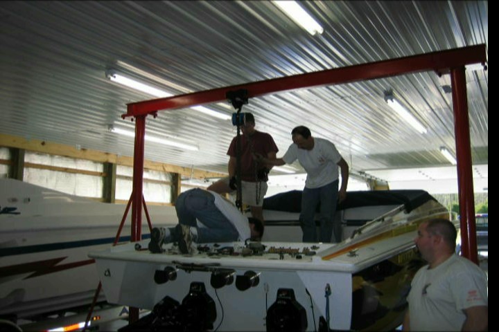

It is easy you also need one of these.......... take your time since you have never done it before.
Attached Thumbnails What does it take to remove and replace 502's?-ipodimage55a_tnc.jpg

Yep.....Last summer I lost all oil pressure and after some testing we figured the oil pickup tube must have broken off. 3 of us started at 8:30 working on a twin engine boat. We pulled the Hyd. steering, drive, engine hatch, exhaust, engine and stripped accessories to get the oil pan off. Found a broken oil pickup tube and went and bought another one. Welded it back to the pump, put the motor back together, re-installed the engine, exhaust, hatch, drive, and steering. Test fired the motor, set the timing and made sure everything was running perfect.
Since the guys helped me get all that done I took them to lunch when we were completely finished....we sat down at the restaurant at 1:00 (just 4.5 hours later!!!!)
Our group has worked together a number of times and have lifts like the one excursion just posted (I've pulled my engines using his lift too). Unfortunately we don't even need to look at the bolts to know what size wrench is needed for each bolt.
And it sometimes helps to take pics of how it all goes back together.
