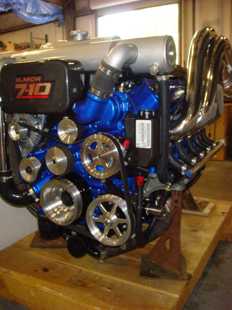

Sen-Dure makes all size heat exchangers and their product is standard on the Ilmor line of engines from 525-725 now.
http://www.sen-dure.com/
Here is a pict.
Uncle Dave
