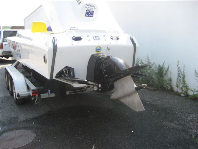

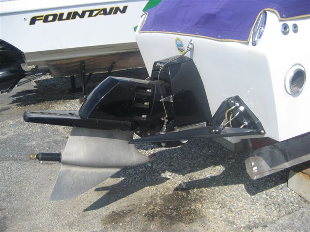

It ends the "Bravo Blues" for sure.
Attached Thumbnails Who's running a #6 in a single engine application-j.c.-performance-040.jpg   Who's running a #6 in a single engine application-j.c.-performance-072.jpg   Who's running a #6 in a single engine application-p767760704-4.jpg
