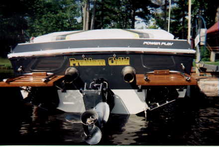

Finially got the bilge all cleaned up....

proof she still is running.. LOL!

again...... sorry about the quailty cheap camera...

Travis: Boat looks good !!! How did you do the diamond plate? Did you brake it youreself or have a fab shop do it? Realy looks good!

Birdog.. I cut it to size then used a buddies brake on it... only had to bend the peices on the floor, I put a 3 inch lip on them to clean up the edge where the floor meets the bilge.. I just used a skill saw to cut it.. LOL!! nice and loud you won't have any neighbors that like you after that glued the sides on with a whole tube of 3M 5200 on each side ! screwed and sealed the peices on the floor..
