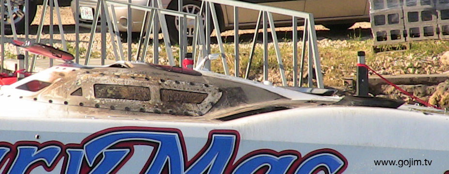

Here's another example for you--Miss Mary Mac, at the 2011 Lake of the Ozarks Shootout.
