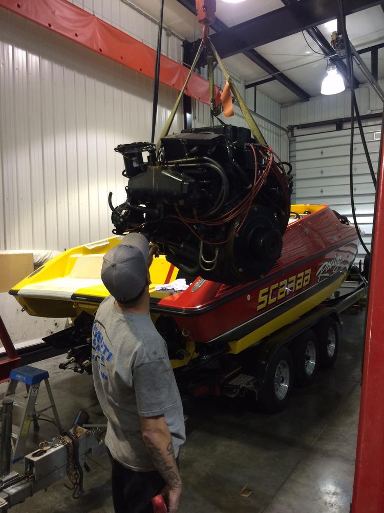

Hole rusted in the bottom of the oil pan.

Coat your new oil pan externally before installment. I forgot the name of the corrosion resistance product that we painted on. I have heard some saltwater marine shops using a coatings like Rhino lining as well. I do not know how well a Rhino lining type of coating will hurt dissipating heat from the oil pan. maybe something to look into if you boat in saltwater to stop rusted out oil pans. FWIW

por15 works well

That's the one POR 15 = (paint over rust) and there is another one we used.

If the one is rusted thru you have to wonder how far off the other one is.
