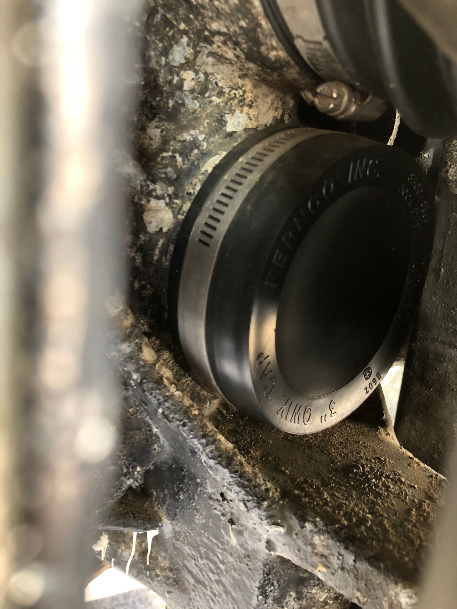

Default Rot
On where your hose is coming through the stringer that may not be rot. Formula didn't always finish up that pass through cleanly. If it is rot its a good time to pull the motors and go over everything in the bilge and make repairs, paint, clean up rigging etc...

Originally Posted by Andyba20
I noticed that too. I felt that spot with my hand and it was solid, almost like someone needed a hole and didn’t have a saw so they just punched it through with a hammer and a screwdriver...something my dad would do. And I see the waterline. It definitely took on water at some point, I just don’t know for how long.
the pass thru area on the stringer looks fine to me...formula probably left it unfinished as many manufacturers do.
i would be nervous about the silicone around the outdrive assembly. There is no need for silicone unless they were leaking. sure fire band aid fix for something that could be a bigger issue.
This drive has been serviced recently it appears. But then again I don’t know much.
A closer view. Looks to me like this sealant was applied at the same time as the gasket. Maybe they reused the existing gasket and added the sealant as a secondary protectant?
Other side of the drive. I don’t know anything about Federal Marine but they have stickers all over the transmissions and drives.
If it were recently fixed...it wasn’t put back together properly. That gasket is supposed to go on dry. No need for added silicone.
1MOSES1 is offline
