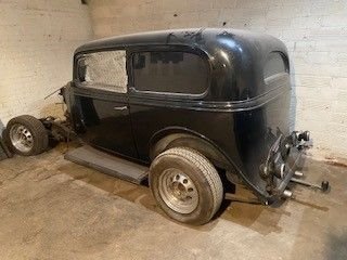

At some point I'll get into this 1935 sedan below, original wood/steel car. I was going to go with an Art Morrison setup (they make a pre-fabbed rear frame setup with Ford 9") or a full on frame either custom built from one of the Ohio shops, or you can order the full chassis from Art Morrison. they have been around a long time, good quality stuff.

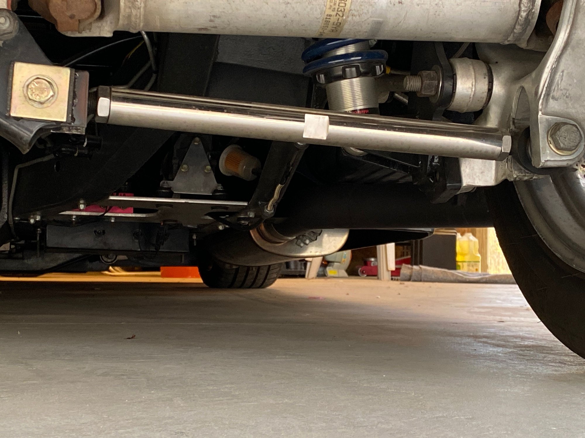

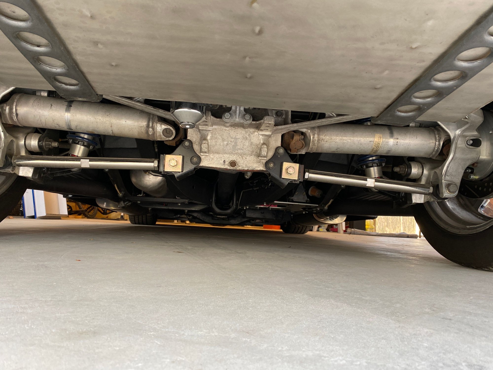

He also built this one, which has a corvette c4 independent rear running a 450hp 454. Runs and handles real well.

Not super great pics but you get the idea.
and like one of the previous members said, he had it setup with airbags, while cool, handled terrible. It’s now got coilovers all four corners and it drives much better.

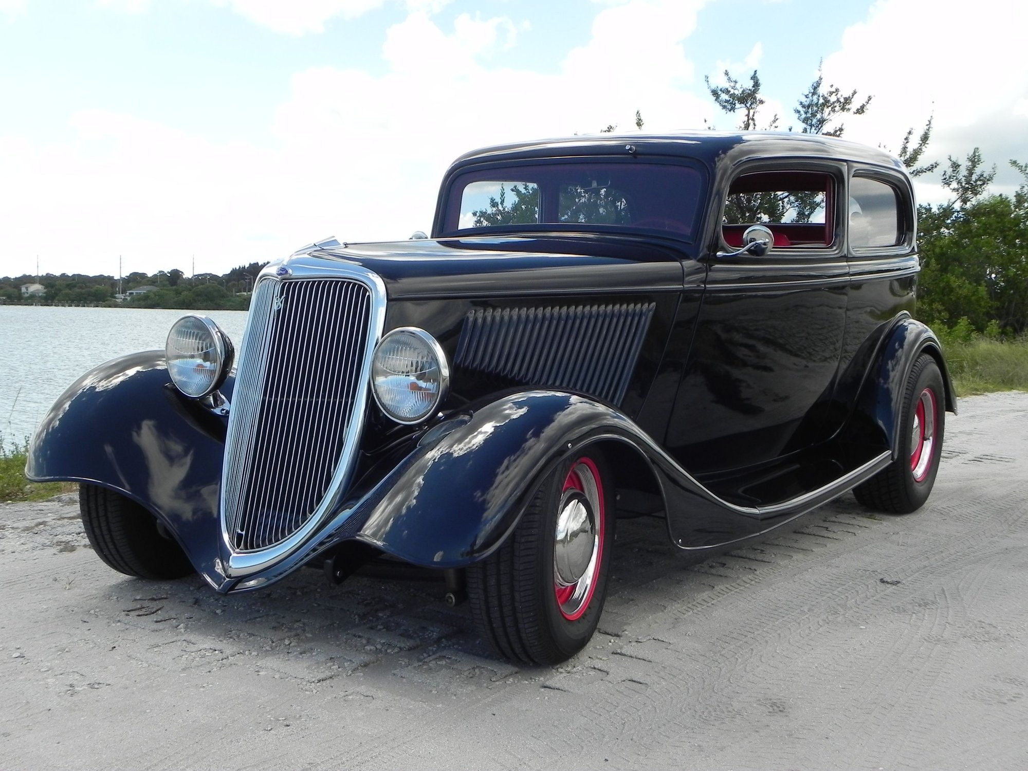

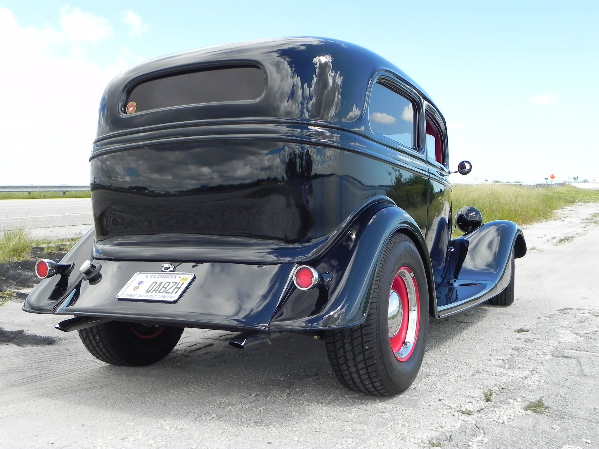

Pics of my 34 Tudor
