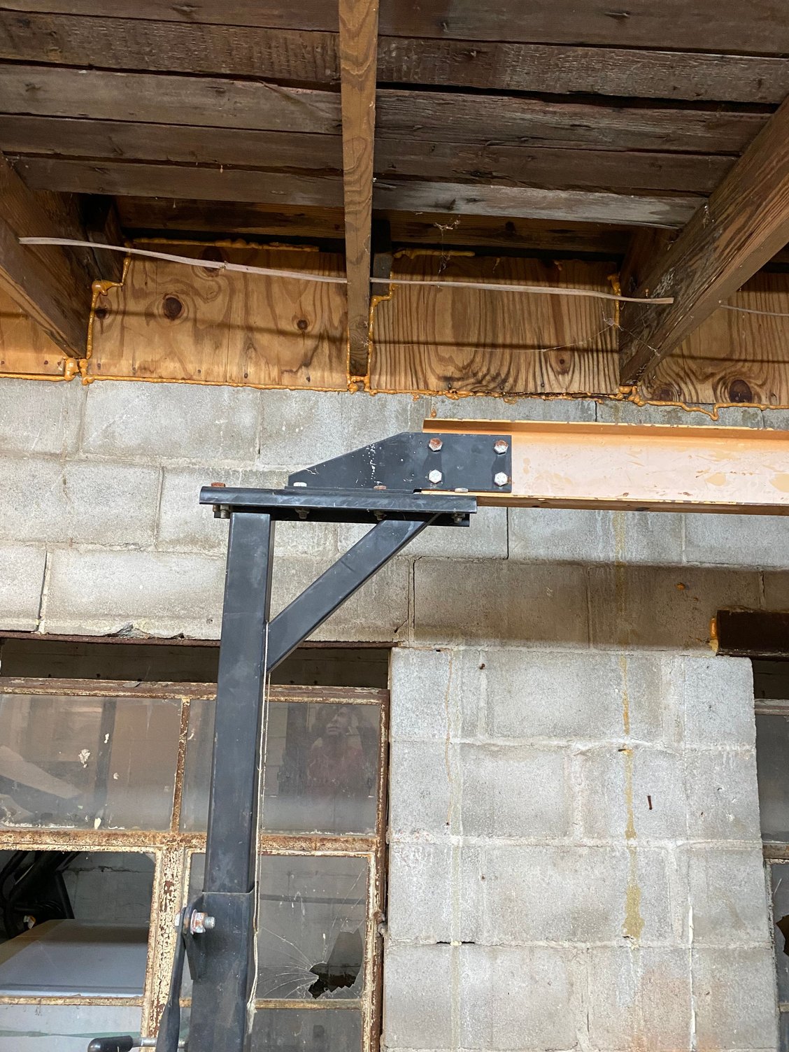

Old 11-29-2021 | 04:30 PM
seafordguy's Avatar
Joined: Jun 2006
Posts: 5,122
Likes: 967
From: Seaford, VA
Just moved mine over as mentioned. You can see where there are 8 bolts holding it and I'm only using 6 on both sides....

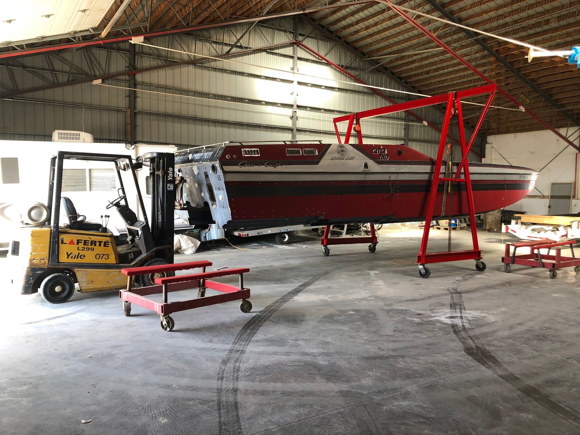

Old 11-29-2021 | 05:31 PM
Joined: Sep 2001
Posts: 1,542
Likes: 55
From: Kingsville----lake erie
I'm so glad i have a forklift -- so much handier than a gantry... if you look you can probably find a running forklift for $2500 and be able to use for other things also... but it does take up a bit of space.
delsol is offline

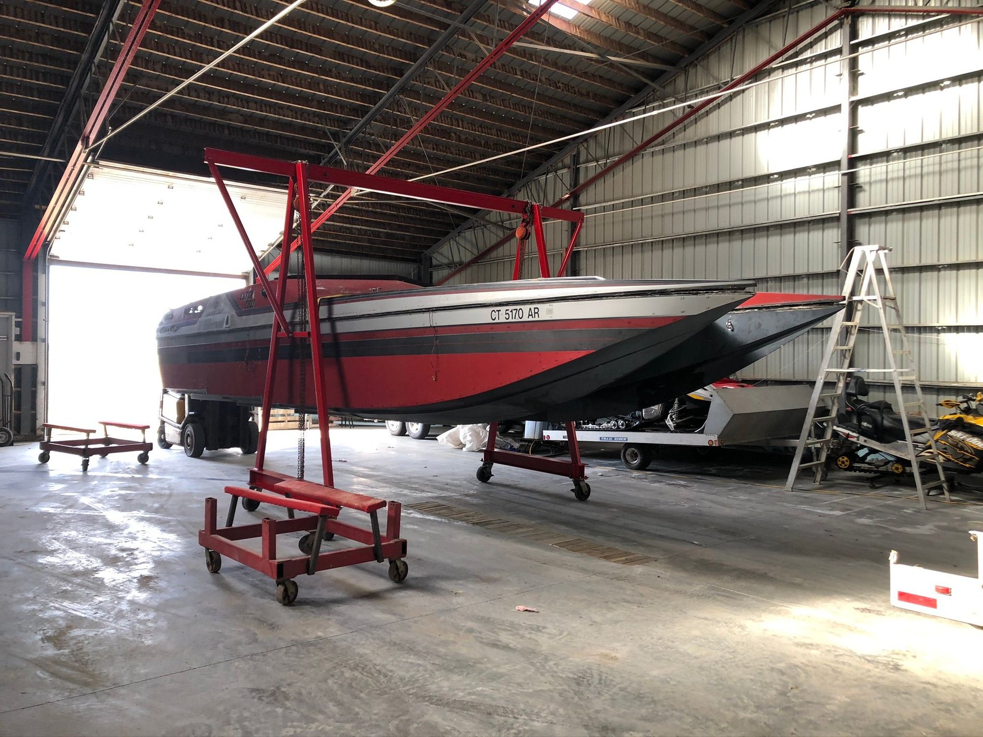

Old 12-01-2021 | 07:17 PM
jeff32's Avatar
Joined: Jun 2004
Posts: 8,230
Likes: 580
Home made here work well!
jeff32 is offline
Old 12-02-2021 | 04:40 PM
Drake22.250's Avatar
Joined: Oct 2011
Posts: 1,188
Likes: 419
From: At Work
Very cool hull, is that a project in motion? Jeff 32
