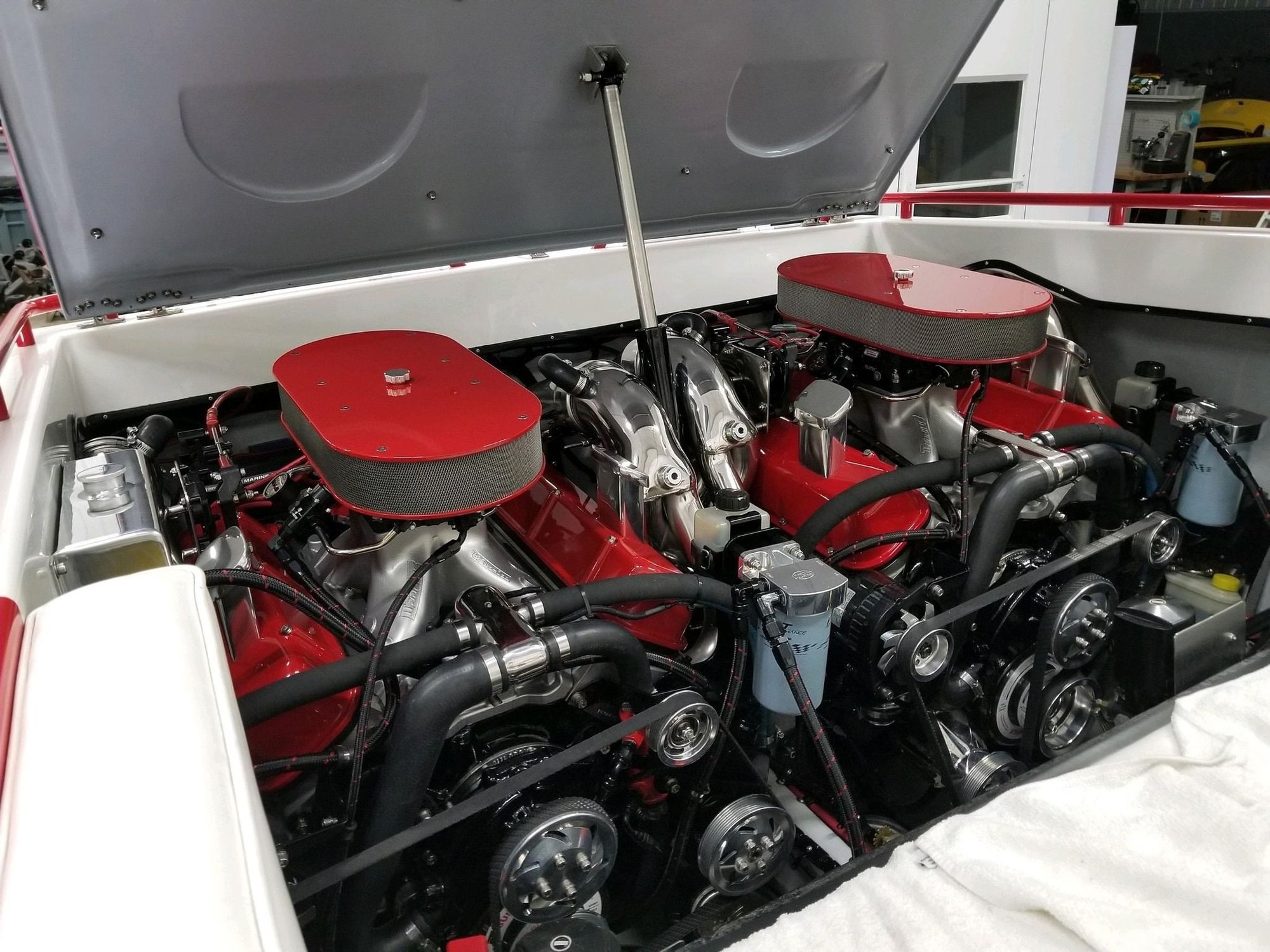

Very Nice! I like the red. I couldn't find the matching red flame arrestor where I bought my valve covers so just stainless. Looking at your photo and others gives me more ideas for rigging my boat. I am waiting for Kyle @ PE to get back to me on the specifics for my engines and the cost. I'm really hoping the other guy comes up with some money but I don't really see that happening. Blood from a turnip and all.
