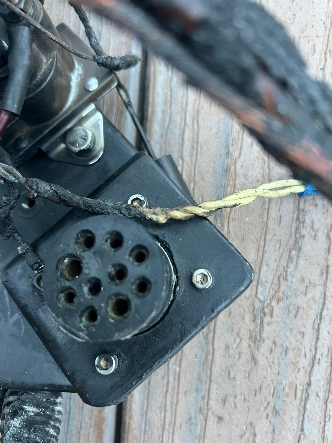

D

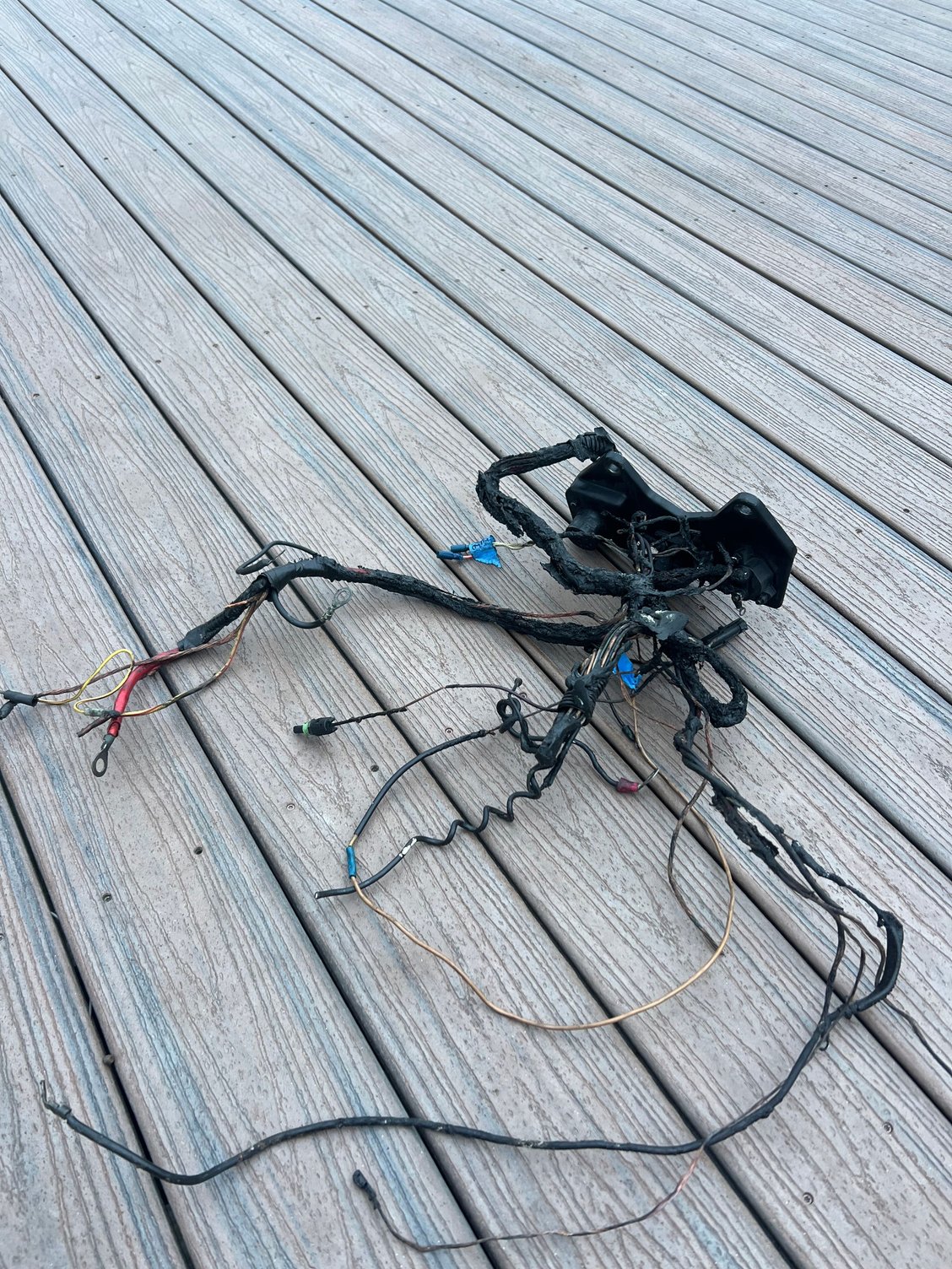

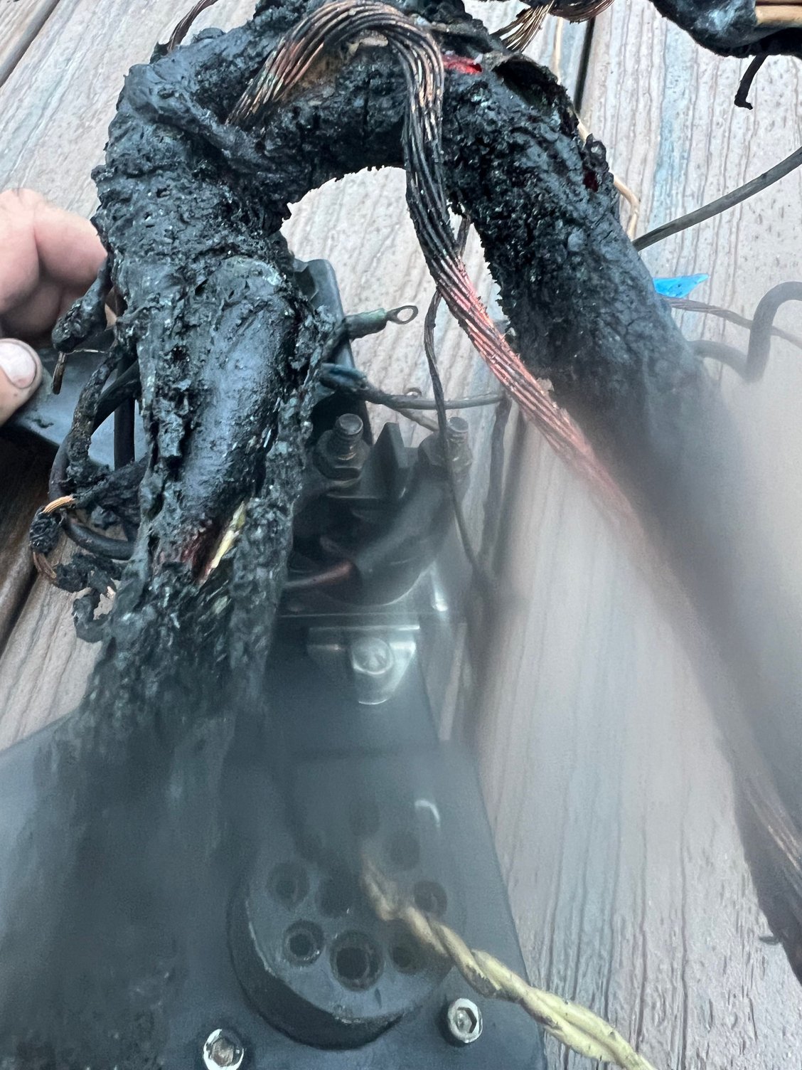

You can Zoom in if you want. Fire very much contained to this pigtail (the female side of the 9-PIN). I think it started somewhere on the Port side of the motor with the wires or connections running back from the alternator. There are wires that just seem to be missing on that side, and the wire coming off the back of the anlternator obviously got hot enough that it burned right through and broke off .
I’m going to need some help from you guys on piecing this back together.
I believe this is probably the harness? Any thoughts?
https://www.hardin-marine.com/p-1661...-ignition.aspx

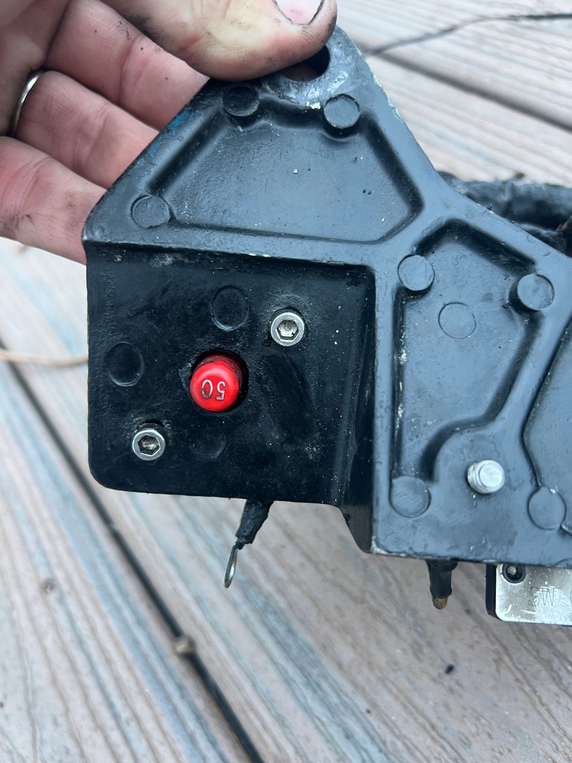

Obviously the 50AMP breaker is going to be replaced
What is the other Solenoid that is back there? I ran out of light, to trace whether that solenoid ran down to the starter or somewhere else. Second to last picture? EDIT - believe that’s the starting solenoid and likely has a Yellow/red that runs down to the solenoid on the Starter Motor???
Don't know what the heII I was looking at.
Carry on...

Originally Posted by seafordguy
D
Seaford,
That is your starter relay. It switches the relatively high current to the solenoid on the starter.
When did the fire start? Starting? Idling? Running accessories?
Thanks. Brad.

Originally Posted by Rookie
I believe you have the 10 pin harness.
Rookie,
I count nine, but there could be a hole hiding behind the twined wires crossing over it. Don't know if there's a pattern difference that a more learned eye would recognize or not.
Thanks. Brad.

I went and checked the Male side (engine side). It’s only 9 pins so I think that one from Hardin will work.
Yes, will order Starter Relay and Breaker.
