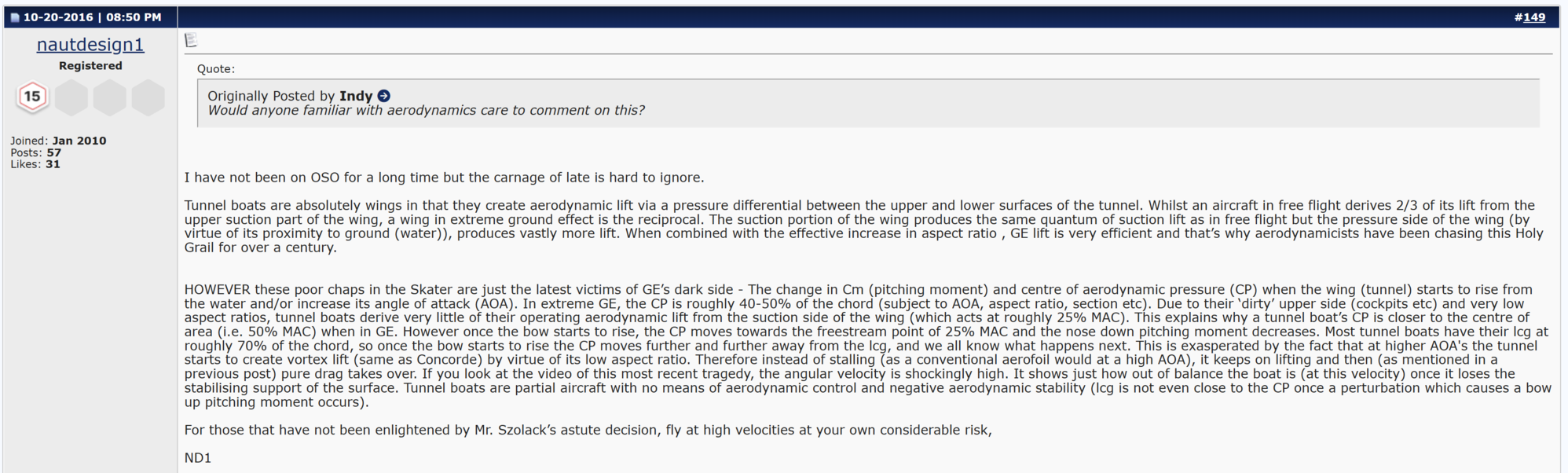

14 years later yet the laws of aerodynamics remain the same.....
