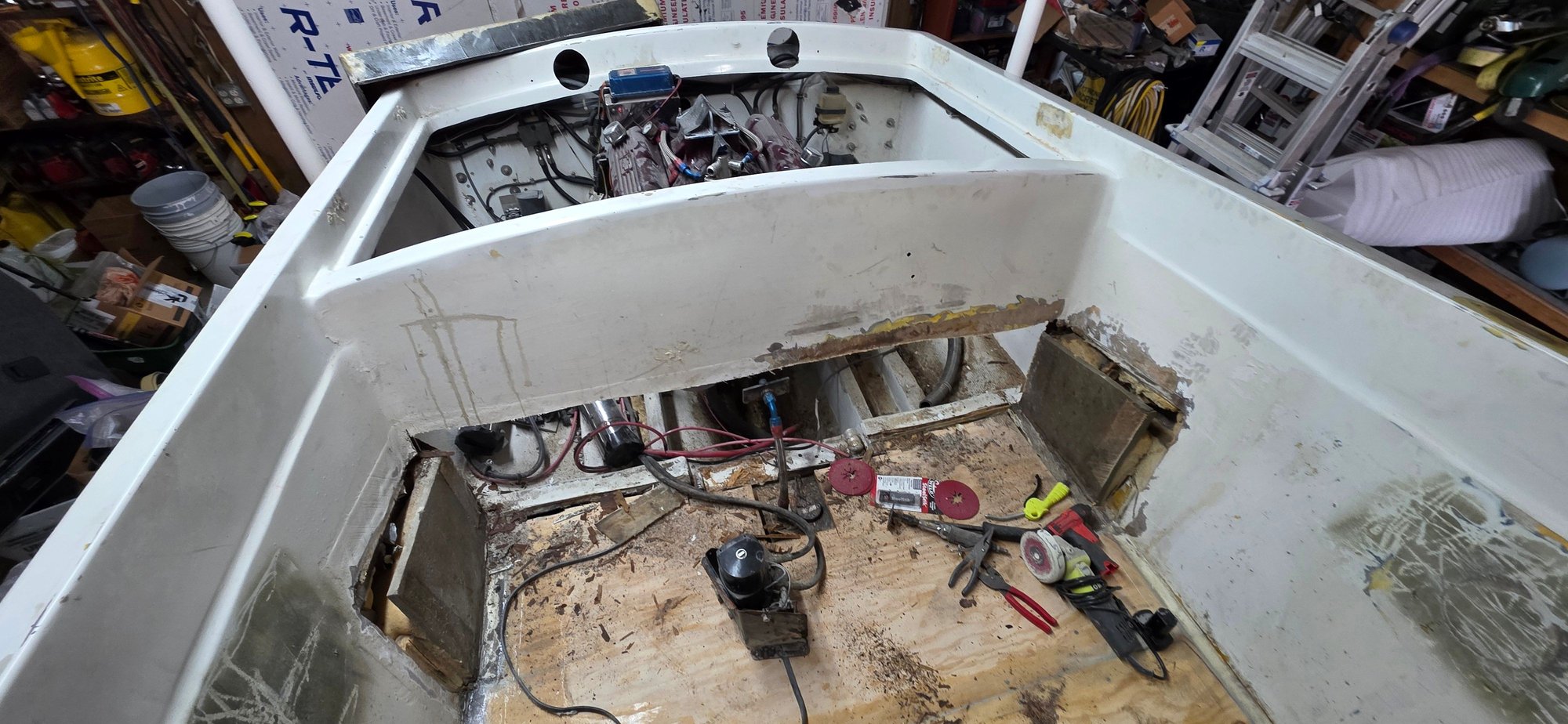

Rest of the floor came out,, darn squishy wood..

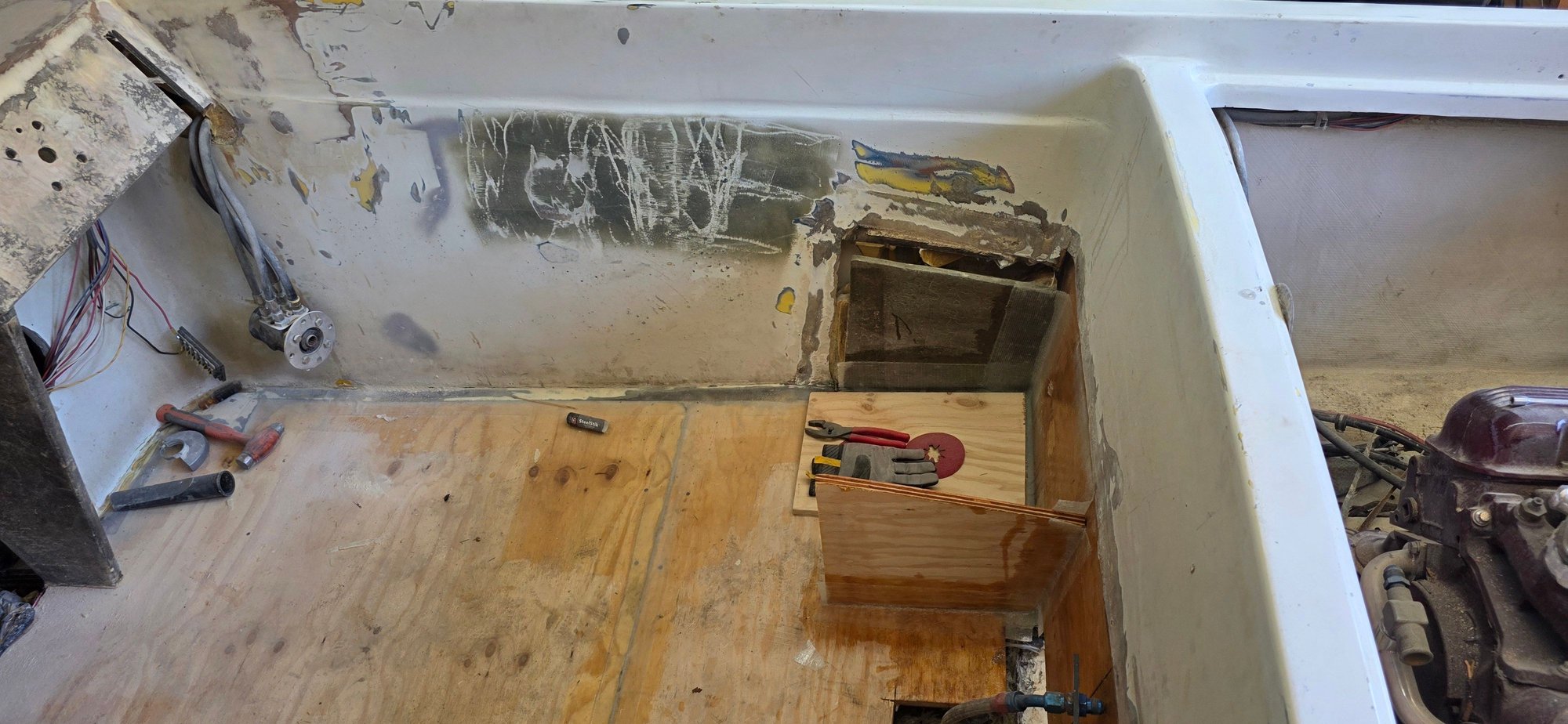

Replaced stringer and new floor

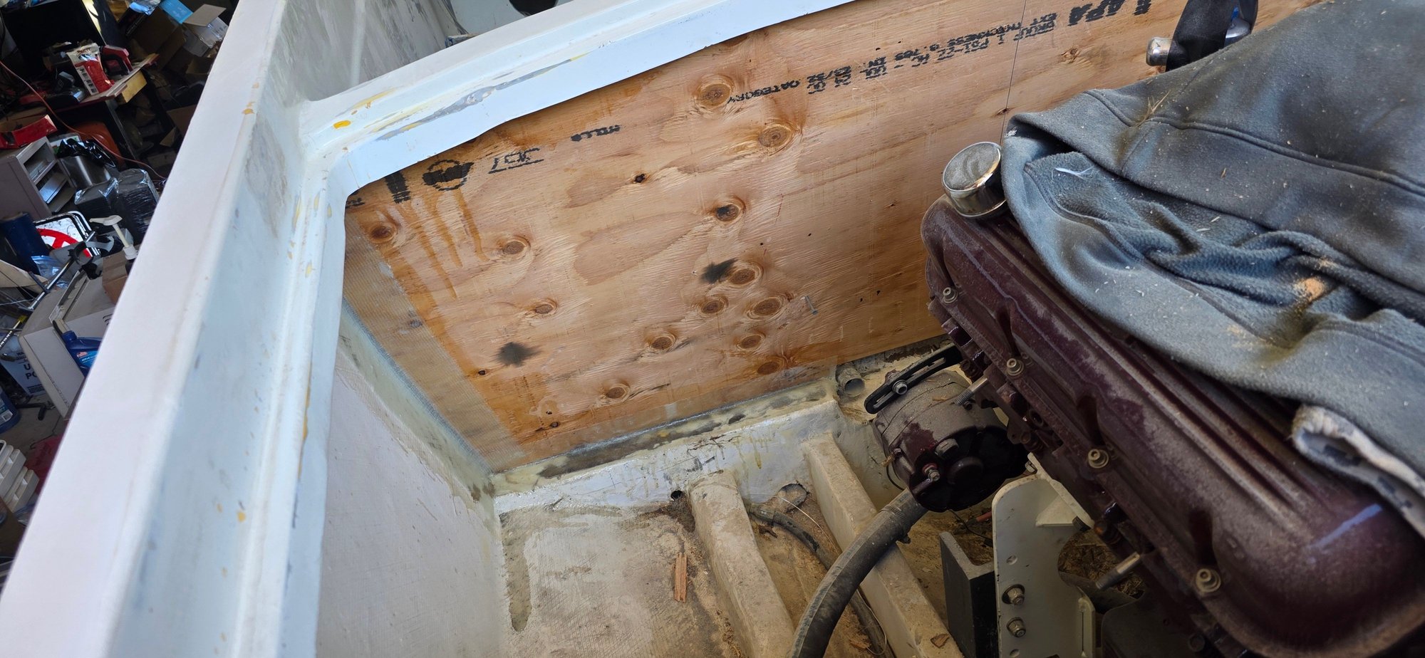

Rear wall was also not in good shape.. saws-all at it again
Fitment was tough, because of the shape...

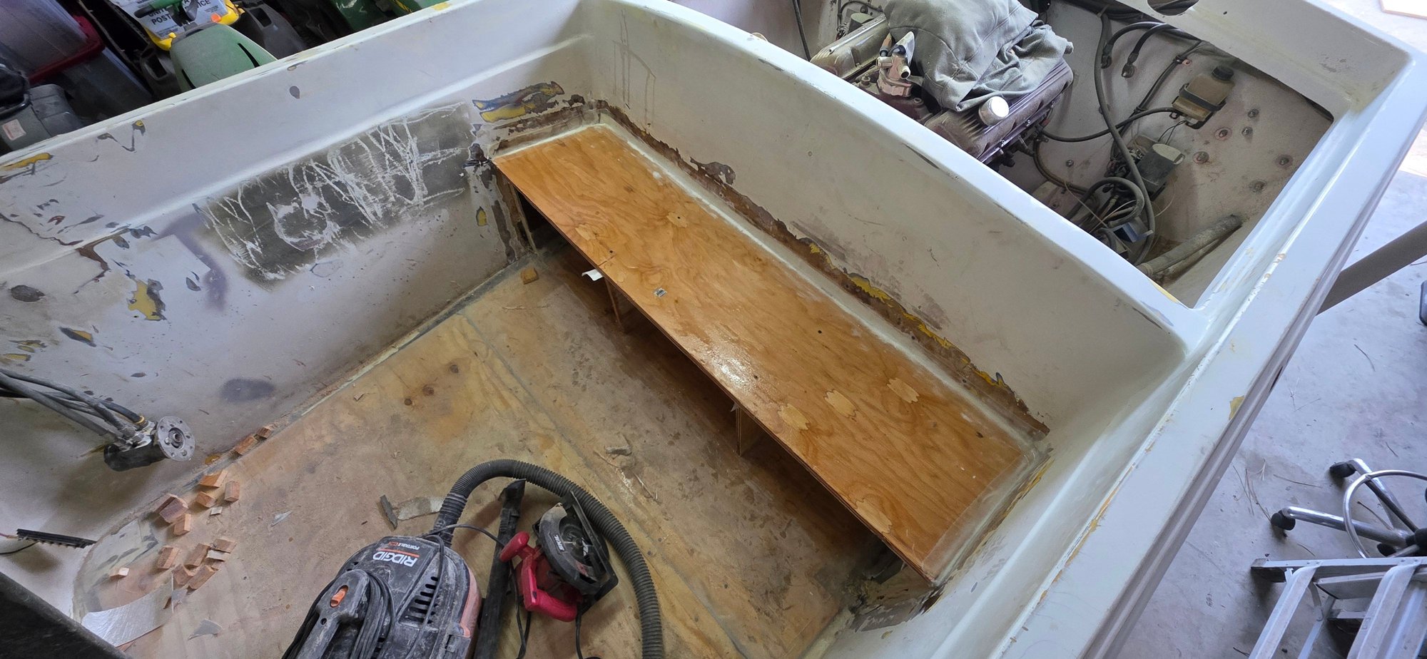

Rear seat going back in

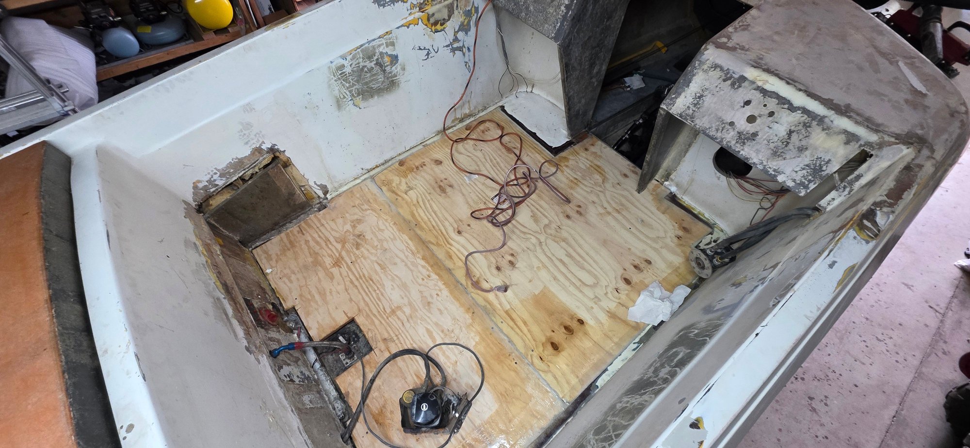

Dad didnt make the dash big enough so i decided to take some notes from early 80s boats and make something work, it will all be glassed in and sealeld

Im using all slow cure west systems epoxy, milled fibers for filler, 8lb structure foam, and some blood, haha
