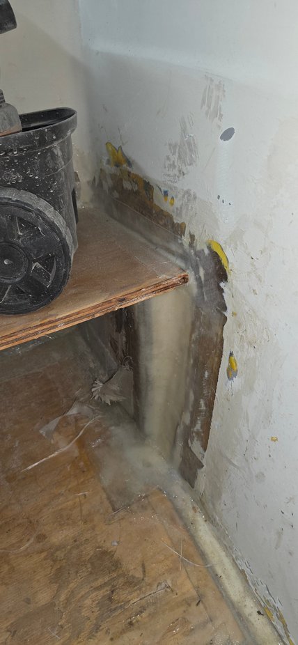

Rest of the floor came out,, darn squishy wood..

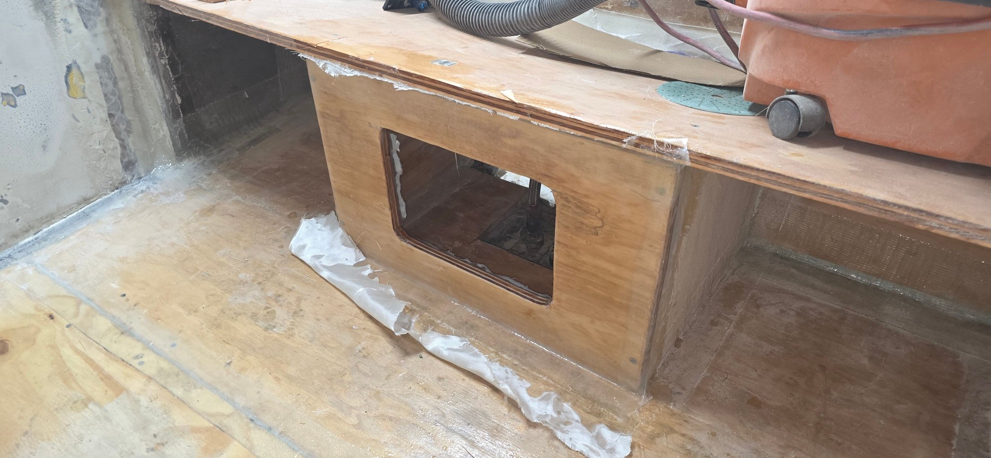

Replaced stringer and new floor
Rear wall was also not in good shape.. saws-all at it again
Fitment was tough, because of the shape...
Rear seat going back in

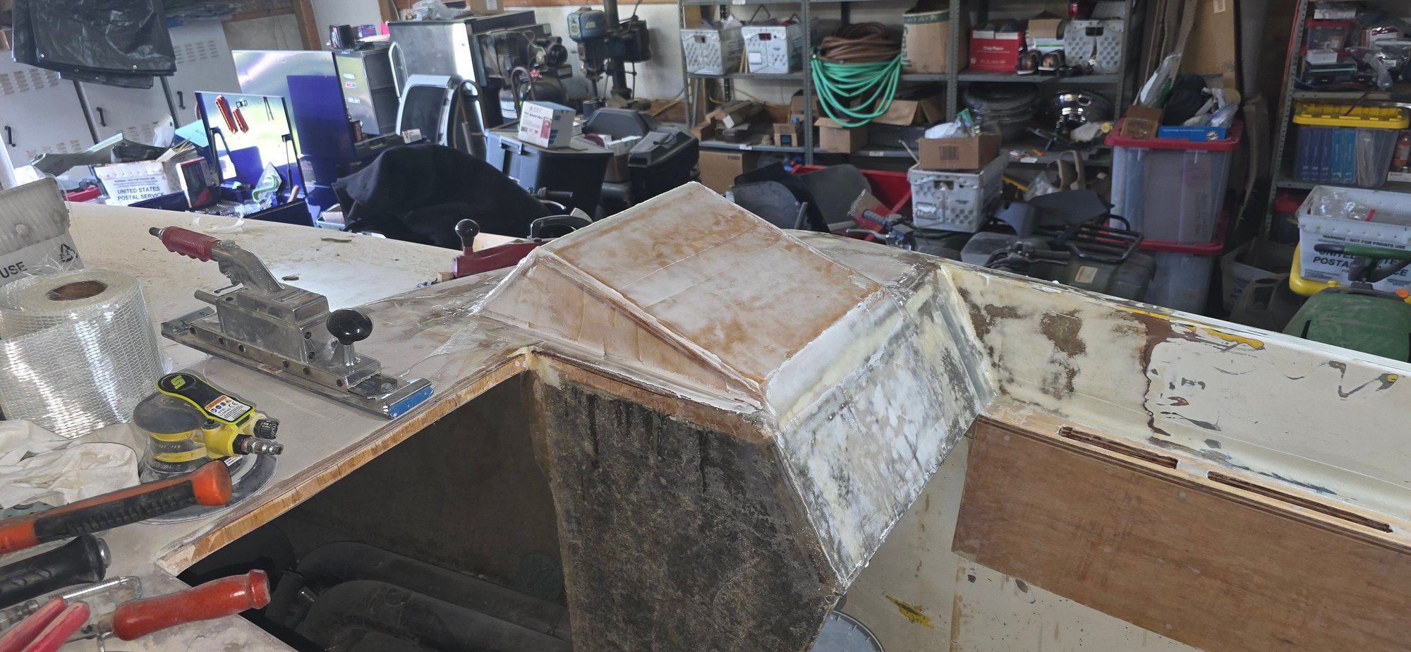

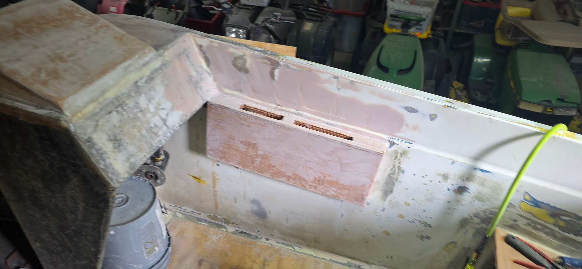

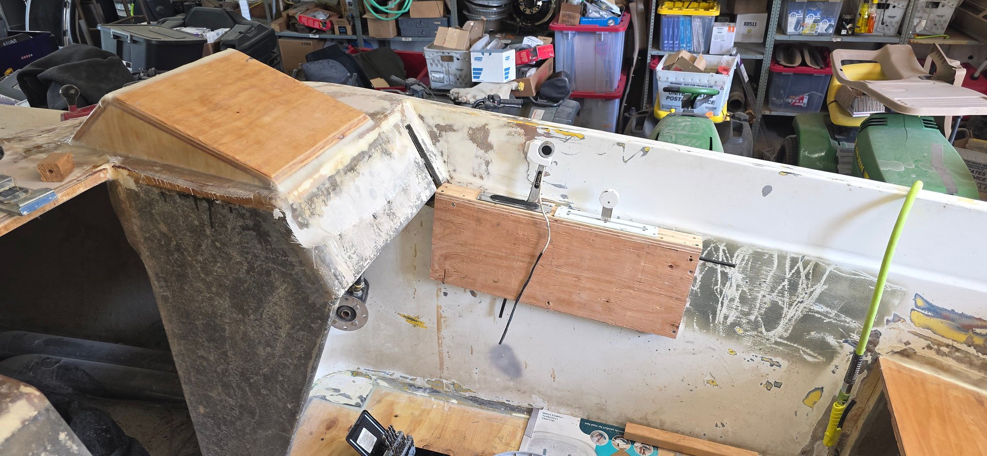

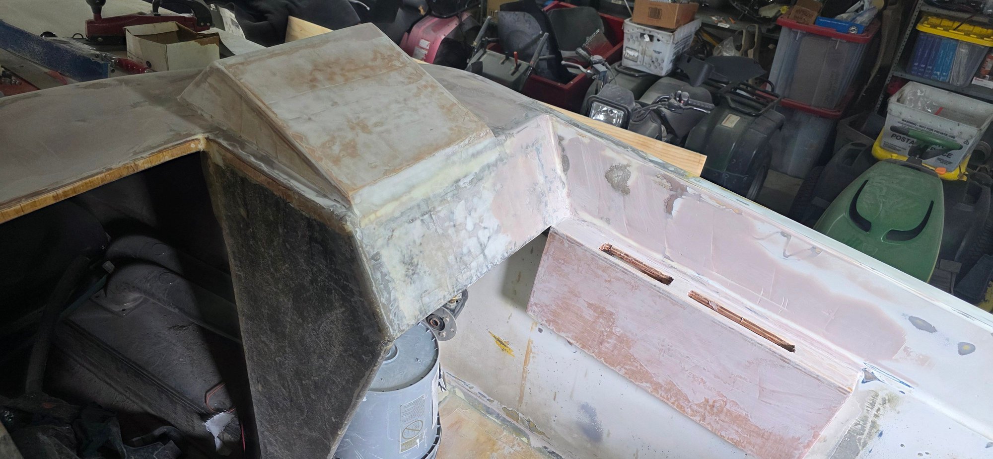

Test fitting the control box, the seat fits nice and its comfortable, it shall do.
Picked up an access hatch, cut to fit, I’ll mount it when paint is on.

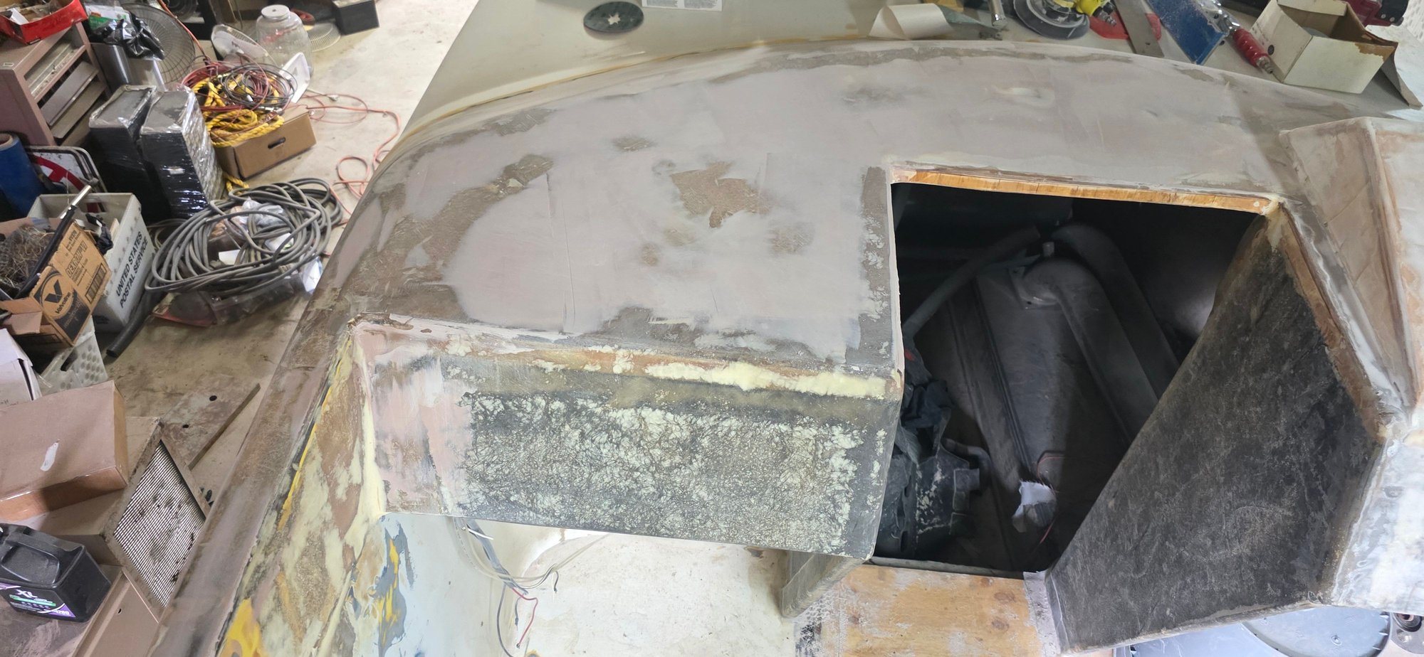

I used Dad’s existing Coosa as the support, back filled with 8lb foam then structural glass/epoxy, I decided to go with the open storage under the seat on the sides with the center closed off, center is the access to the fuel pickup/ sending unit.

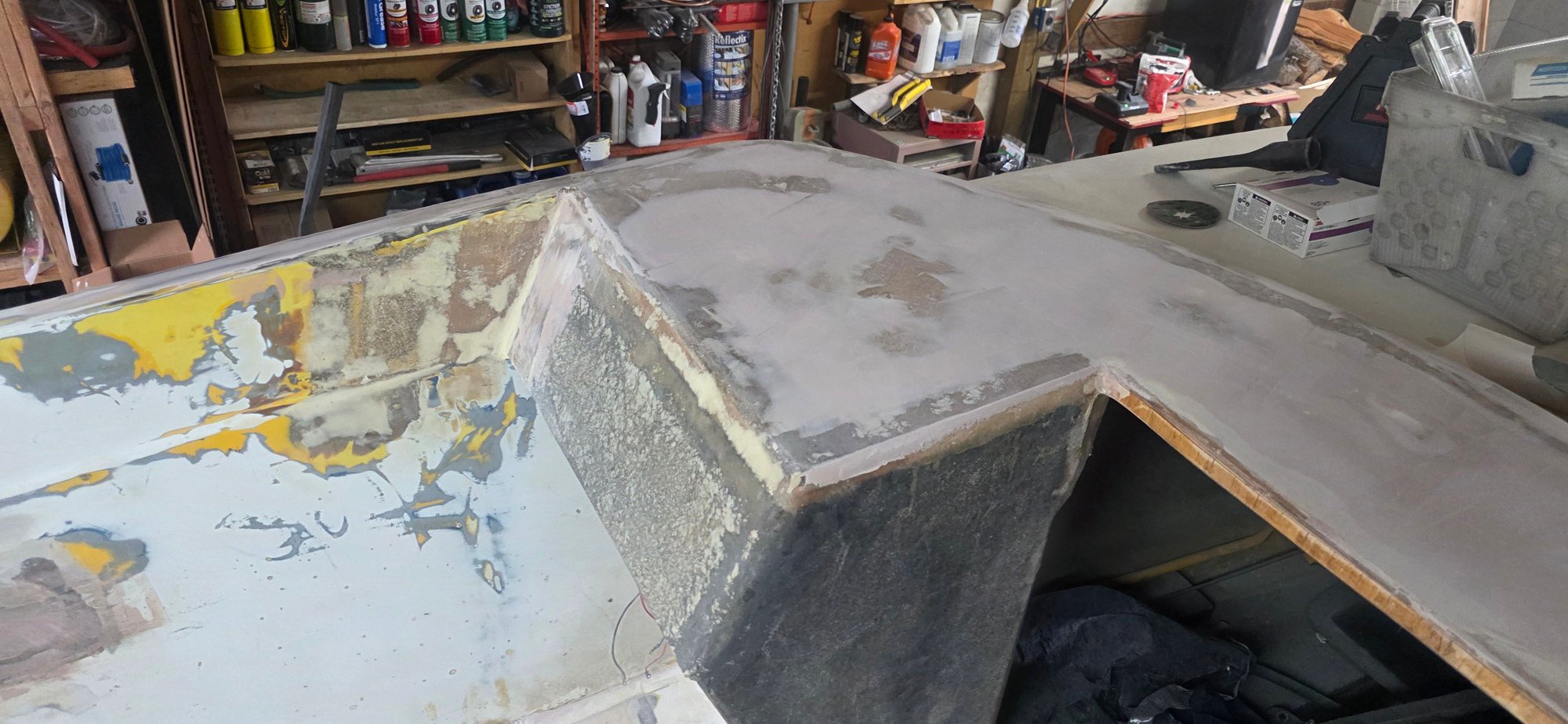

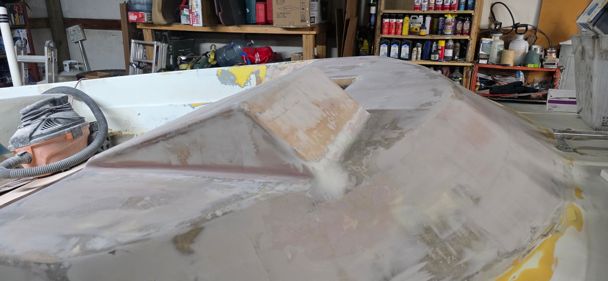

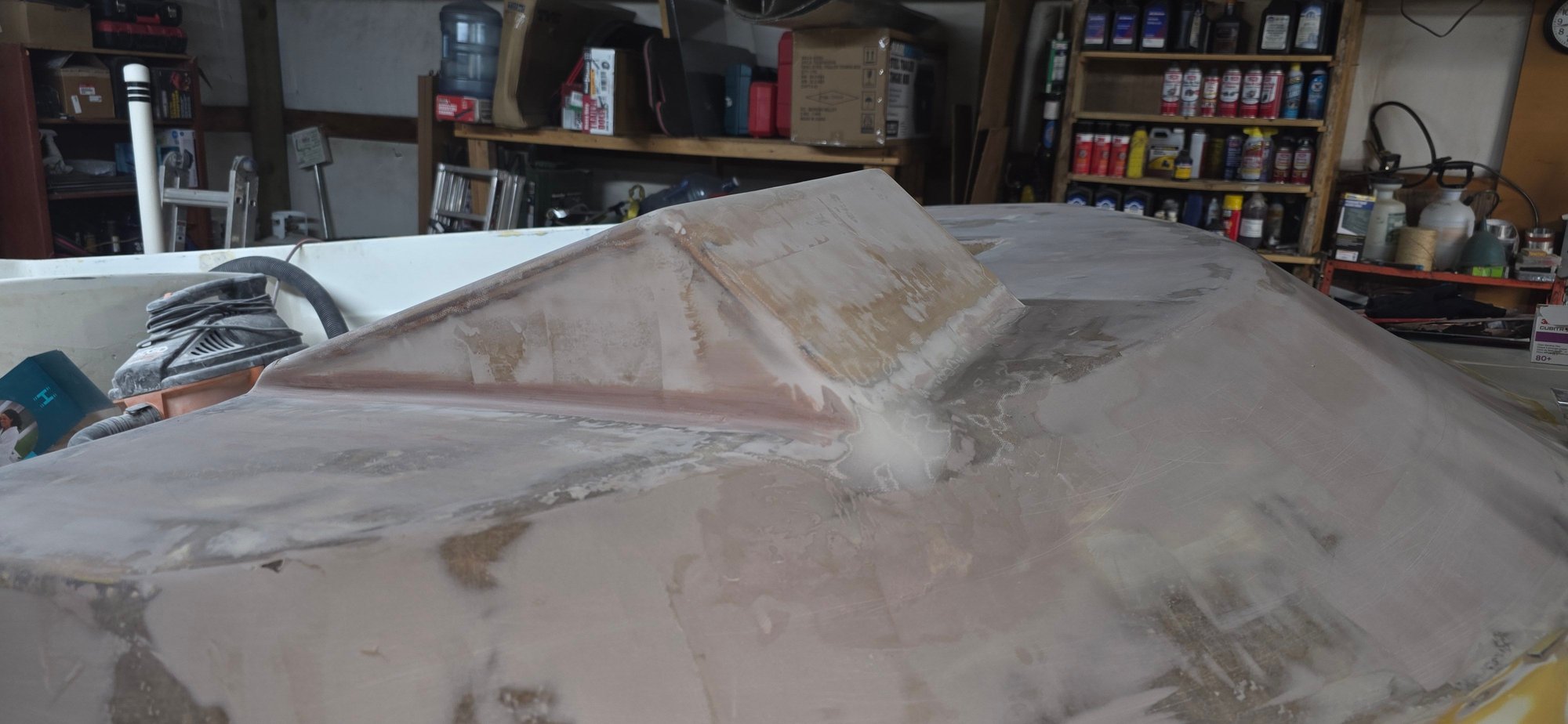

Filling/sealing the gauge cluster
Difficult to work on this, and run a buisness at the same time… also, why didn’t anyone tell me this boat stuff is expensive???

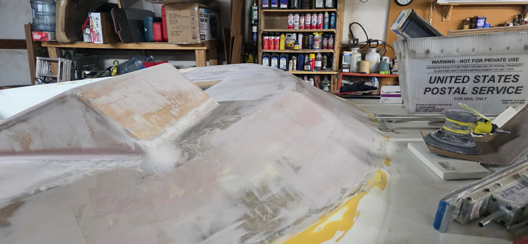

The filler, I got most of the way with Epoxy and microbaloons, now were down to the thin body filler and blocks… my arms are already tired.
