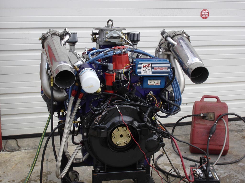

If you have access to a band saw and drill press you can make one pretty easy out of billet plate. I made this one, with the cannon plug. Pardon the mess, this was a test run after the dyno to check my wiring.

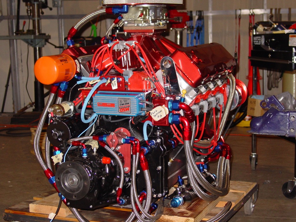

I made mine out of alum, Now that I am getting the Whipple I have to remount it.Prob make it out of stainless next time
I made it with the rive nuts[blind nuts ] so if ya have to take it apart ya not fumbling with the nuts and washers .I put it on top of the ECM bracket and put 2 blind nuts in the ecm bracket also. Cost?Free Buddy had some scrap and I used his break.
Attached Thumbnails MSD Brackets-bolixi-race-prop-etc-014.jpg   MSD Brackets-bolixi-race-prop-etc-029.jpg   MSD Brackets-bolixi-race-prop-etc-030.jpg

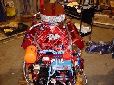

Those type brackets are not too hard to make if you have access to a saw or mill
